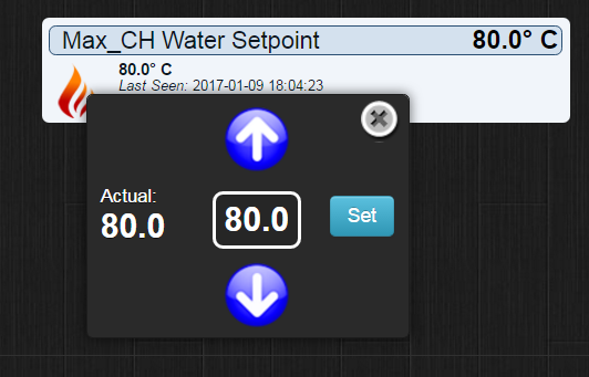

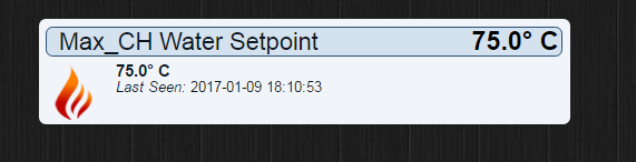

Hi there,
does anybody know what the MAX_CH Water Setpoint actually exactly does?...I was playing altering it from 80 to 75 degrees via domoticz sending a command to the OTGW which seems to work well. See pictures.
I reckon it's a sort of Maximum water temperature of the central heating system as the name implies preventing the CH from boiling water in the radiators.
The question is ...is there anything lese i should know about this setting?
