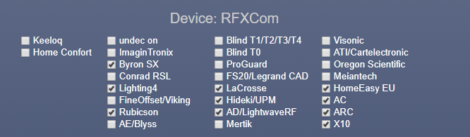

For the RFXtrx433E use Ext2 firmware and enable the Lighting4 and AC protocols.
When you push a button on the Cotech remote it will be received as Kangtai in Domoticz.

Kangtai is controlled by Lighting5 - Kangtai, Cotech in RFXmngr.
I guess you need to receive the remote to create the Kangtai device in Domoticz. Enable receive of new devices in Domoticz and try with only Lighting4 + AC enabled.
