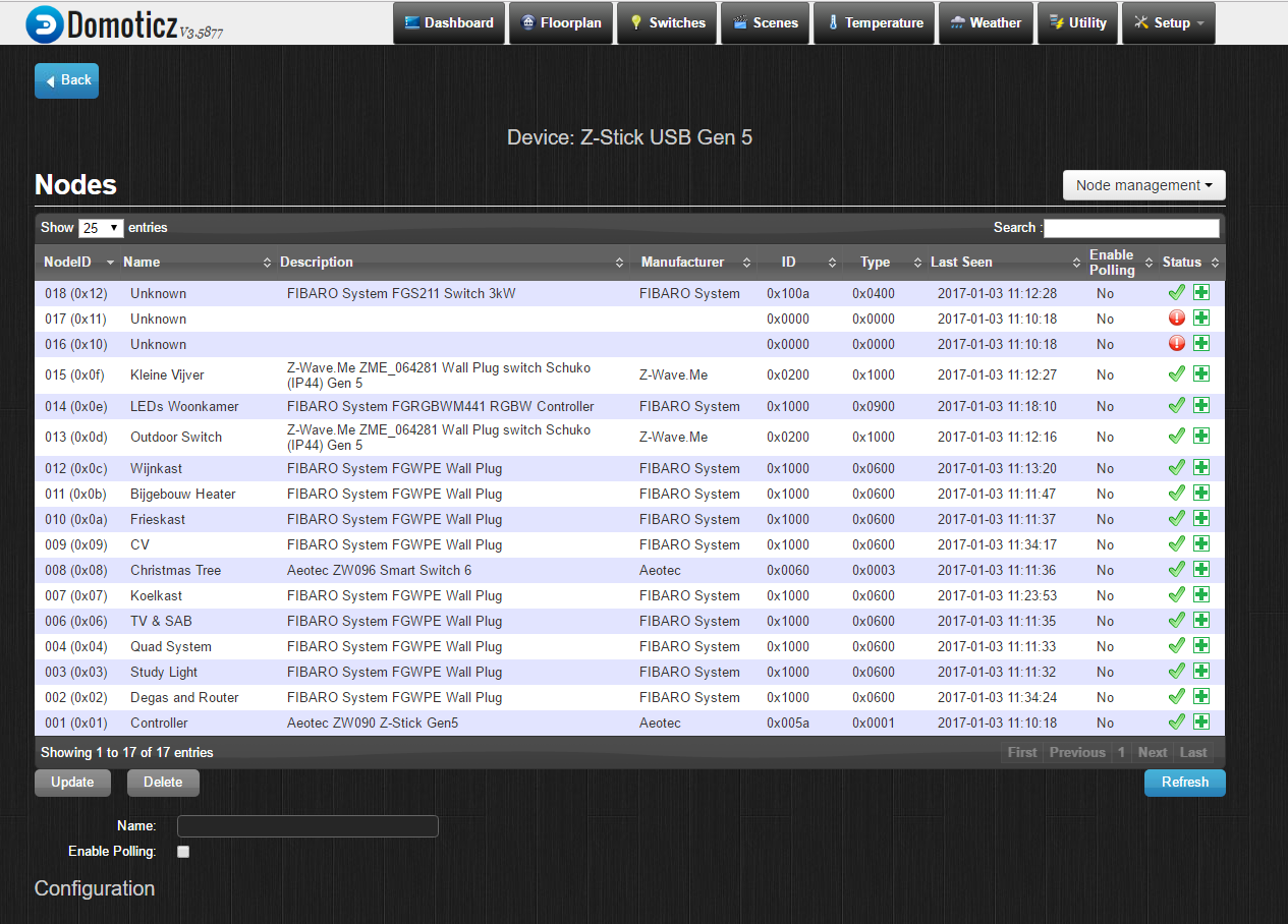

This is getting ludicrous. I've now reset the Aeotec USB controller, and rebuilt the network. Now both the new Fibaro FGS-212 relay switches are being reported as dead - and the product ID and type are being reported as 0, so they are also not being recognised in Domoticz. I'm rapidly losing confidence in the system.
Domoticz 59.png (210.56 KiB) Viewed 1134 times
