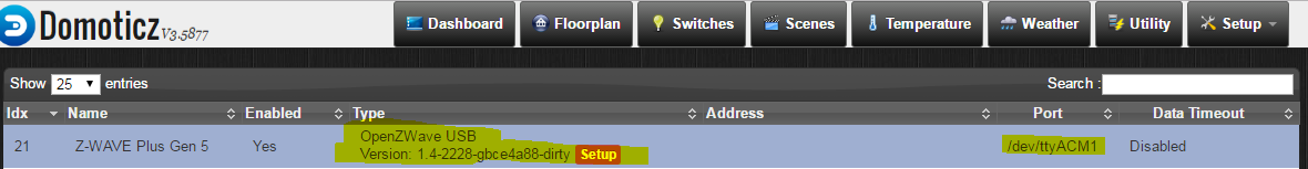

Now I decided to try with OZW, so I bought Aeon Z-WAVE Plus Gen5 stick, installed new hardware (pictue below):
and what next? Shoud I see controller it self when I click "Setup"?

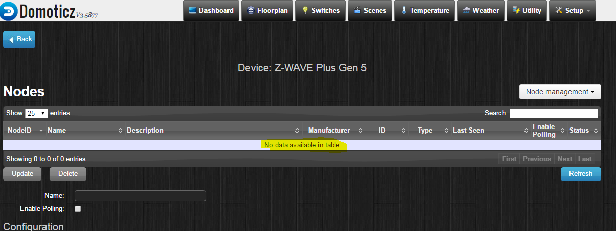

This's what I see now:
My first Z-WAVE devices that I try to integrage is Danfoss living connect 014G00012 SW 2.51 (OZW support).
I've tied Node Management -> Include node/secure node -> press "discovery" (middle button on thermostat) in mode "Li" on device it self, but nothing apears in Domoticz :(
Does anyone of you integrated those devices, how to work with it?

Is this the open version of Danfoss Living Connect?
I am using 10 pieces of them with "13" at the end without problems. (only clock isn´t working)

I believe only 13 is supported.
