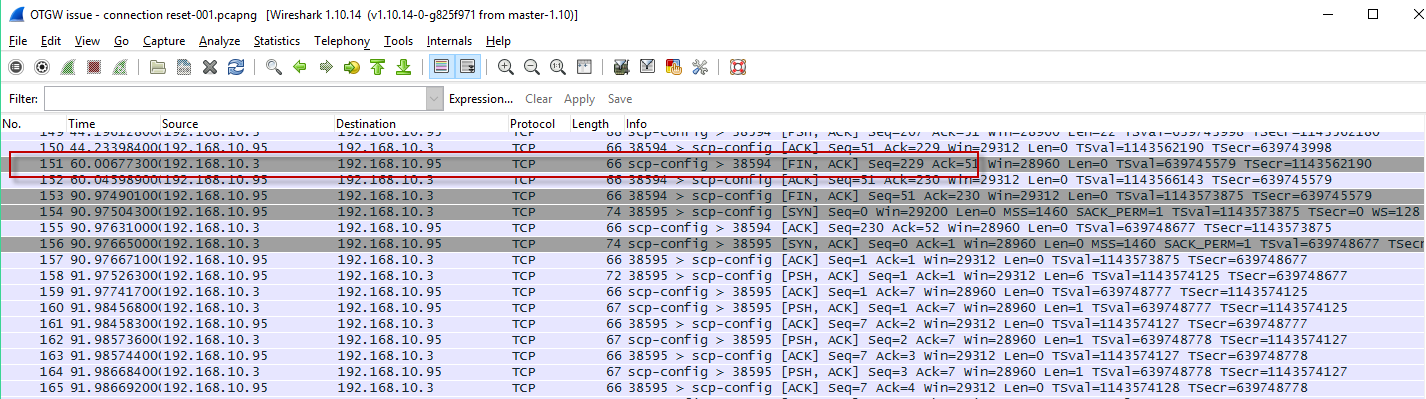

Then I captured the network traffic to find out more about this OTGW reset. This is a snapshot:
Network capture.png (89.64 KiB) Viewed 3652 times
It seems that the frame received from the OTGW (source 192.168.10.3) including the [FIN, ACK] results in the 'OTGW: Connection reset'.
Question:
Is this continuous resetting of the OTGW connection the normal behaviour or is there something wrong in my setup?

Update:
Found the reason for the connection reset.
In the OpenWrt firmware running on the TPLink, I had added the following configuration line to the startup script (according several descriptions I had found at the time):
echo "10001:raw:15:/dev/ttyUSB0:9600 NONE 1STOPBIT 8DATABITS" > /etc/ser2net.conf
This specifies a timeout of 15 seconds (during which there is no communication) after which the port will be closed. Therefore the port on the TPLink was closed after each request since Domoticz reads data from the OTGW only every 30 seconds.
Changed the timeout to 60 seconds and connection stays open now.
