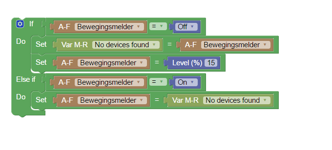

You can make this in blocky.
IF Motiondetector == off
dimmer_value_old = dimmer_value
dimmer_value = 15
If motiondetector == on
dimmer_value = dimmer_value_old
(Look at attachment, make a user variable to store old value)
