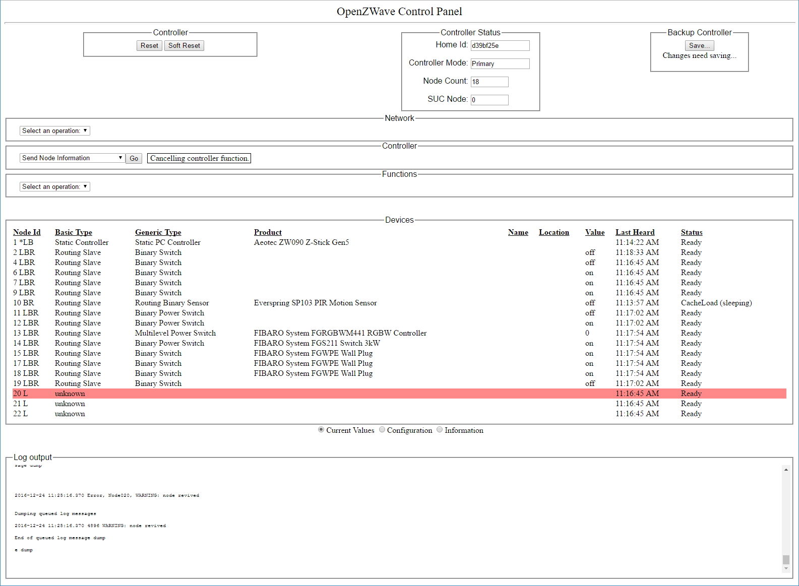

Woke up this morning to find problems with my Domoticz system. Three devices which were known yesterday (an Aeotec Smart Switch 6 and two Fibaro FGS 212 relay switches) are now showing up in the Openzwave control panel as unknown, and only as listening nodes. Domoticz still has them in its list, but naturally reports errors if I send a command to any of these devices. I've tried a network heal, but can't revive them.
Any suggestions as to how to get them back in operation, or do I have to remove all three nodes from the system and add them back in again? Thanks.

You could try commands like 'Has node failed' and/or 'Refresh Node Information' of OZWCP.
Give it a little time between different commands.
I asume you already did a shutdown and power up?

Thanks for the suggestions, but I'm afraid nothing has worked.

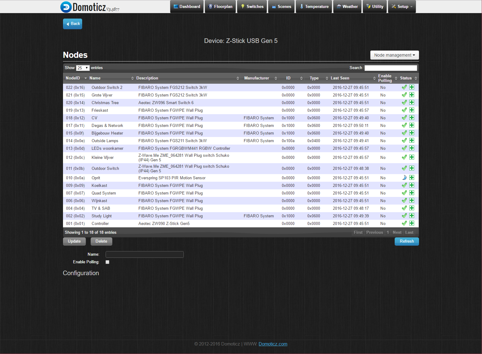

@Domosapiens - thanks, that seems to have done the trick. The switches are now all working, but I notice that the network information table looks odd.
I can't add Group information to any of the three switches (the top three 20, 21 and 22 in the screenshot), and Group information seems to be missing from a lot of the devices. I'm sure it was present a few weeks ago when I last visited this screen.

Domosapiens
Posts: 232
Domoticz version: V3.5981
Re: Zwave Control Panel Now Showing 3 Unknown Devices
Post by Domosapiens »
How can you expect help if you don't tell what type of devices it are?
At least post a snapshot of the list of nodes.
Are they discovered by Z-wave according the correct type?
What was in the log file when you included?
What is in the zwcfg_0blabla.xml about these nodes (post in between code brackets)

@Domosapiens wrote: "How can you expect help if you don't tell what type of devices it are?"
Look, I'm sorry if I've offended you, but much of the working of Domoticz remains a complete mystery to me, and I often don't know what is useful information to provide to aid in diagnosing issues.
Here's a screenshot of the OZW control panel showing the list of nodes at the time when the last three nodes were not working:

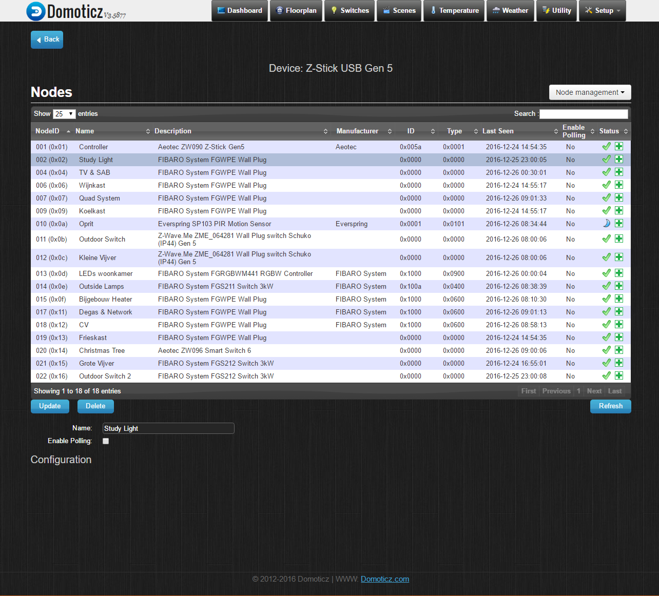

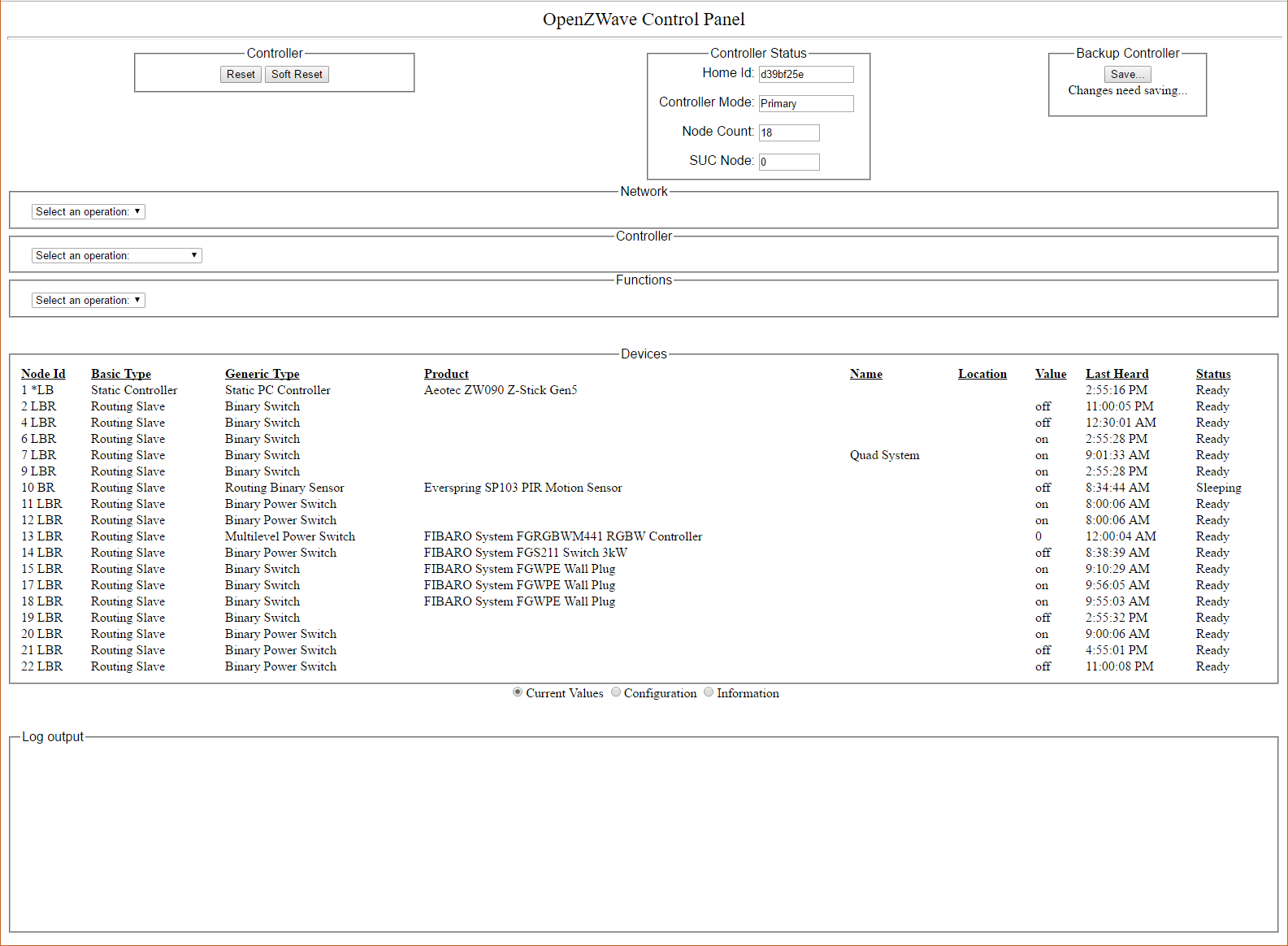

After following your suggestion (thank you again), here's the list of nodes as they now stand:
Domoticz 55.png (99.75 KiB) Viewed 8388 times
It seems to me that things have improved, but I notice that the Product data for these three nodes is still blank. Indeed, I notice that product data from other nodes is missing, and I'm sure that this was all present and correct originally.
If I list the nodes in Domoticz (as they now stand), then it seems to me that product data has been lost from the system somehow. Here's a screenshot of the nodes, with node 2 selected. Notice how the Manufacturer's data is missing, along with the entire Configuration section, and the ID and Type values are both 0x0000 - shouldn't they be 0x1000 and 0x0600?

It seems to me that data has been corrupted somewhere along the line, and the question is, is the source of errors the Aeotec USB stick itself, or in the Domoticz database?
I'd post the node information from the zwcfg_ file if I could find that, but the file seems to have completely changed in its structure and content, and nodes (other than the controller) are no longer listed in <Node>...</Node> sections...
If I need to delete the entire Zwave network from both Domoticz and the USB Stick and rebuild it, then so be it. It's a real pain, but it's probably better than trying to patch up the data.

Ok. You did not offend me.
This info brings us somewere.
The zwcfg_0blabla.xml file (blabla is your specific Z-Stick number) is a file that is enriched for every node you include and used by Domoticz to store intermediate values.
Did you modify one of the manufaturer specific xml files yourself?
(if so, a xml file error in such file will disturb all successive node inclusions.)
All nodes with ID 0000 are not included correctly.
Because there are so many, my suggestion is:
- open a log window
- stop Z-Wave (disable your stick)
- backup and then remove the zwcfg_0blabla.xml
- enable you Z-stick
- look in the log how the zwcfg_0blabla.xml will be rebuild
- catch the errors, if there are any
Rebuilding the whole network is an ultimate solution, not needed yet.
(but if you do: first exclude the nodes!)

The end result is that the node information is the same as shown in my previous message - the errors have not been caught and corrected.
You asked if I have modified one of the manufacturer-specific xml files myself. I did - over a year ago - and added information about a Z-Wave.me outdoor switch. But that modified file hasn't been in my Domoticz setup for months now, since it is now included in the OpenZwave library.
Domosapiens
Posts: 232
Complicated ...
2) Removing the USB stick is not correct!
Disable the stick on the hardware page: click on the Z-sitck Gen5 line. Uncheck the box and push update.
Did you delete the home-made Z-Wave.Me ZME_064381 Switch xml file? No leftover in the folder?
About all those timeouts ...
Is your Z-stick hidden behind your computer, or can it transmit in free space.
Use a short USB extension cable to bring it to free space.
For test purposes also disable Wunderground and my Slimme Meter (minimal disturbance during the Z-Wave discovery phase)
All nodes need to be recognized with the correct ID, before we can go on.
- open a log window
The message: All nodes queried is the moment that the zwcfg_0blabla.xml is rebuild again
gcoupe
Posts: 57
Joined: Saturday 24 January 2015 14:43
Domoticz version: v4.10717
Post by gcoupe »
Ah - sorry for my misunderstanding about "disable", here's the result of following your instructions properly...
The homemade ZME_064381 xml file has long since been deleted. The current entry is from the OpenZWave library (it was added a year ago).
The stick is sitting on a windowsill (plugged into a USB holder so that the stick is vertically oriented. The USB extension cable between the holder and the computer is about 1.5 meters long.
Here's the log file during the regeneration phase:

And here's the result - still having the problem that devices aren't being recognised properly. Could this be caused by the timeout errors?
Domoticz 56.png (325.73 KiB) Viewed 8323 times
Domosapiens
Posts: 232
gcoupe ... complicated ..
- those timeouts are not correct
- the nodes with ID 0000 are not correct
Just a guess: cable too long? Quality insufficient?
Just a guess: try another position. Could it be reflection and wave interference from the window ?(isolated glass has a metal raster inside!)
The registration of a node is a multi-step query process, explained here:
http://www.domoticz.com/forum/viewtopic ... 271#p40847
Can you post the first line of node 4 (as example) from the the zwcfg_xxxx.xml
It will look something like this
   <Node id="18" name="Unknown" location="" basic="4" generic="17" specific="6" type="Motor Control Class B" listening="true" frequentListening="false" beaming="true" routing="true" max_baud_rate="40000" version="4" query_stage="SecurityReport">
to see in what stage the hick-up is.

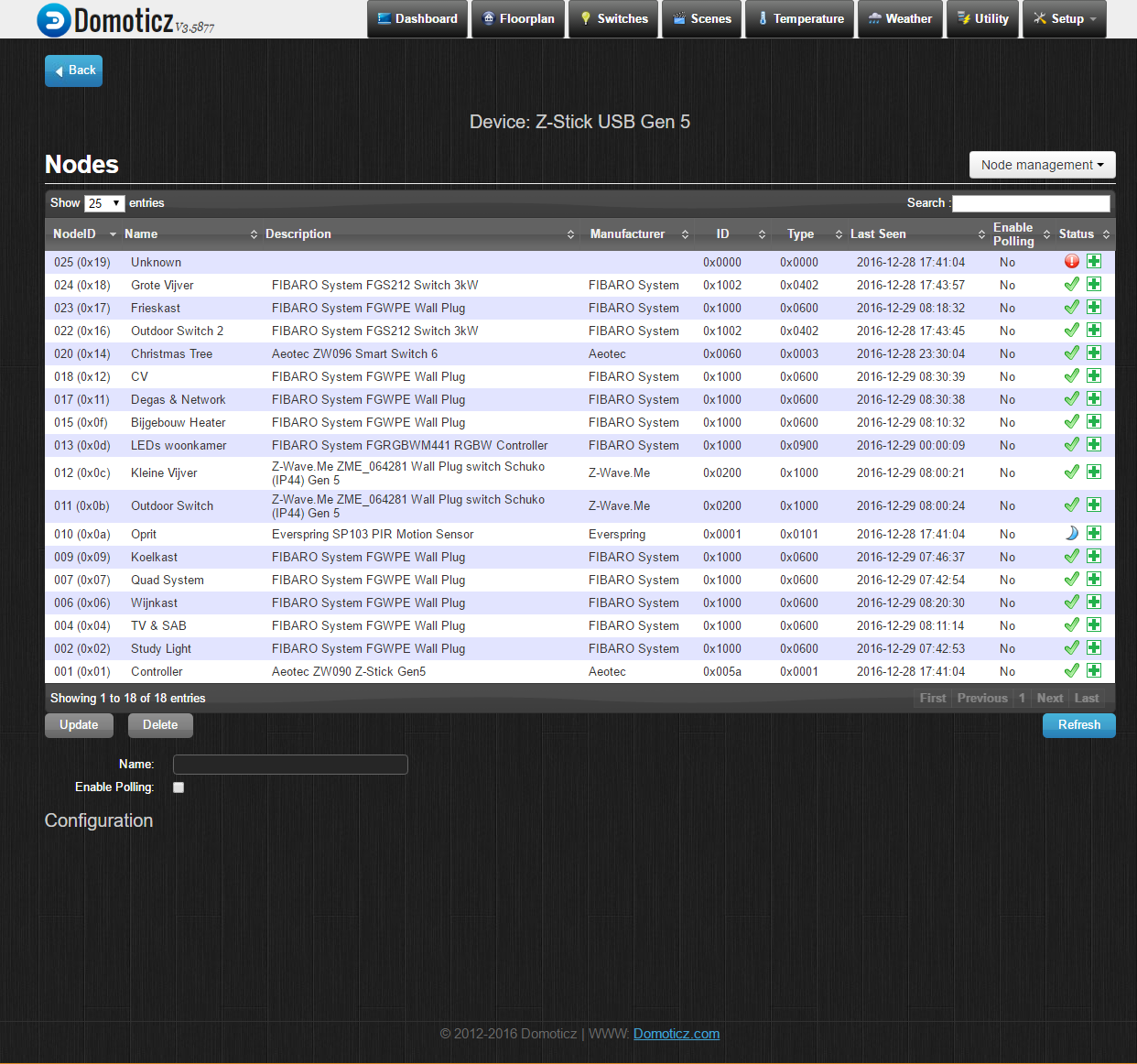

So, I've almost got a fully-working system again (thanks to Domosapiens), but there's one problem that still remains at the moment.
I've had to exclude and then re-include all the nodes that were marked as dead - but one node (node ID 025, previously 014) refuses to come alive. It's been excluded and then included, but the Aeotec USB stick is still reporting it as dead. This is despite the fact that the exclusion/inclusion process clearly worked. It's also not because the node is out-of-range in the network - in fact it's the node physically closest to the stick (3 meters away).
How can I make the USB stick see the node as working?
Domoticz 57.png (253.14 KiB) Viewed 8209 times
Domosapiens
Posts: 232
Nice to see that you have progress.
What did the trick ? Moving away from the window?
Now for node 025:
- disable your Z-Wave stick
- backup zwcfg_xxxx.xml
- edit zwcfg_xxxx.xml:
- delete the part: <Node id="25" ....upto .... </Node>
- make sure you do not corrupt the xml structure! (using a xml editor with syntax check make life safer!)
- safe the zwcfg_xxxx.xml
- enable your Z-Wave stick
Check node 25 as soon as "all nodes are queried" is in the log
gcoupe
Posts: 57
Post by gcoupe »
@Domosapiens, thanks for the suggestions.
I'm still getting some timeouts, but they are from nodes out in the garden and outbuildings. I'll keep experimenting with different cables and positions. I see that the Aeotec Zstick has a setting to enable a nightly Heal Network at 04:00. Is it worth turning this on, to keep the network in shape?
Node 25 was still being reported with no manufacturer name, and with 0 for the ID and Type numbers, so I ended up removing node 25 and adding it in as a new node. That seems to have worked and I now have the network back to normal. Thanks again for your help.
