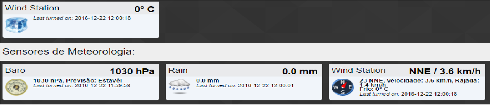

I have domoticz v3.6224 and rflink fw version 45.9 that i use to receive the signal / data from my weather station.
At this moment i can receive the data from the rain sensor, temperature and humidity from outside and wind speed / direction.
My problem at this moment is that on domoticz when i put the wind sensor has favorite to show on the dashboard i'm getting a temperature card with the same name as my wind sensor card but this temperature is always 0º
And on my wind speed info i have the info off the temperature saying also 0º
How can i fix this and get the real temperature and not 0º ????

the uploaded image is broken, so can't see what you mean.

Yes the rflink as a debug window on windows and i don't see any problem in the debug window.
This card showing 0º only shows over domoticz dashboard Like other users on the forum says they get child 0º...
I'm having other strange problem now.... and this one bothers me more.
The wind directions on domoticz don't show wind on "south" e never get data on this side.
I have the wind direction calibrated to North and i do get the south value over the LCD station.
Now i don't understand why this two problems happen.
