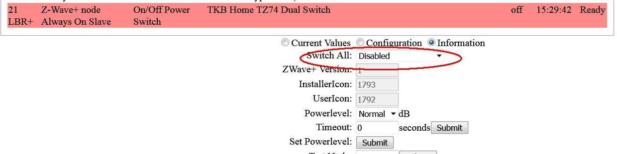

akamming
- Posts: 422
- Joined: Friday 17 August 2018 14:03
Re: TKBHome association
i just received my 1st TKBHOME TZ74 switch from AliExpress. It worked rightaway without modifying any XML files. Maybe the latest domoticz already includes the xml which is in this topic.
However. I have another (weird) problem.
- Both builtin switches are working correctly if I only use 1 (e.g. one light on or the other) light switch all works well. I can use both light switches correctly, however i cannot have them switched on at the same time.
- if both switches are set to on, then after about 15 seconds the attached lights go out. After this event, the switch is unresponsive for about 5 seconds giving error lines like "2018-09-21 13:29:43.898 Error, Node018, ERROR: Dropping command, expected response not received after 1 attempt(s)" if i try to turn the lights back on
- then after about 5 secs, automatically turning both lights are being turned on again
- and then after 15 seconds the whole process repeats itself endlessly, until i set one of the switches to off.
- In domoticz the value of both switches remains 'on' the whole time.,
i think the device is resetting itself, because when i turn off the memory function in the zwave configuration (which according to the documentation controls wheter or not the device remembers the previous state after a power outage) of the device, both switches are put to off after the 5 seconds of inactivity, and the loop is not started.
Does anyone have a clue on how to fix?

Check the statistics in the OZW control panel. If the device has already gone unstable, the request RTT will be normal, but the response RTT will be very high. It will be impossible to change any of the unit's settings.akamming wrote: Friday 21 September 2018 13:50 Hi,
KR Arnold
Finally found out how to stop this. Power cycle the switch, then in the OZW Control Panel highlight the device. In its information box, set Switch All to disabled. Do this before sending any other command. It will not "take" otherwise. That setting is persistent.
. If this was changed successfully, the RTT response time should be nice and low, typically 30-50 instead of 1000+ and the other device settings can now also be changed. I did not need to exclude/reinclude, this time, but ymmv.
Still not impressed by these devices, but at least they are usable now.
