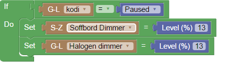

i have managed to set up kodi to domoticz, so when i now play a movie i see the move title, and if i play or pause the move, it is all shown in domoticz,
i have set up some simple blocklys for some of the light at home, if a switch is triggered it will automaticly shut down after 60 mins.
but i guess that is my limit, i really dont know how to set the incomming events from kodi to switch of some of the lamps in my house.
i have looked at every block in blockly, but i cant figure out how to set it up.
i have also read that link that you provided above, but it didnt make me wiser.
I would really apericate some futher guidence, maby wich blocky i should use?
thanks in advance.

- Posts: 562
- Joined: Sunday 11 December 2016 13:51
Re: Turn switch on when pausing kodi?
Hi!
i actually think i got it working, i tried different things in blockly, and i set it up like the picture shows.
This seems to work, when i pauses some of the lights turn on, but it seems like its only the logic blocky, paused that works.
none of the playing and stopped works, i really dont know why.
Does any one else know why none of these logical, like Playing, Stopped or stopp works?
I would like to get the lights to turn of after i stopp the movie.
[img] [/img]
thanks.
[img] [/img]
thanks.
- Egregius
- Posts: 2592
- Domoticz version: v2024.7
- Location: Beitem, BE
Try with 'different' than Paused. Like != or /=

- Posts: 562
thanks for your answers.
i tried everything in the blue pause block from the picture above, but nothing cant trigger the light to turn on when i stop the movie, pause works great for just pause, but nothing for stopping the movie.
any other suggerstions?
- Posts: 562
i didnt really uderstand that "different", how could i ad != and/= ?Egregius wrote:Try with 'different' than Paused. Like != or /=
- Egregius
- Posts: 2592
In the dropdown where you select the equal sign there's also 'not equal' indicated by a equal sign with a slash thru it:
Notice: just try to help, I never use blockly...

- Posts: 562
I apreciate your help, i will give this a try later.Egregius wrote:In the dropdown where you select the equal sign there's also 'not equal' indicated by a equal sign with a slash thru it:
Thank you.
