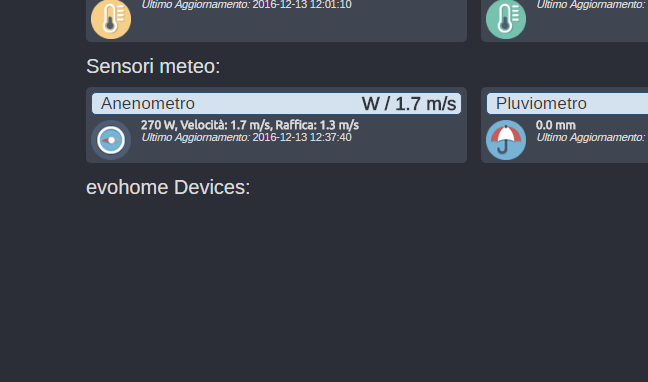

Hello guys,
  in my Domoticz system I implemented the control of my Honeywell EvoHome WiFi via script (https://www.domoticz.com/wiki/Evohome#S ... _or_RFG100).
Everything works fine except for a boring detail. :|
Despite not having entered my EvoHome Touch as a preferred device, the dashboard shows the writing evohome Devices
Does anyone know how to remove this writing?

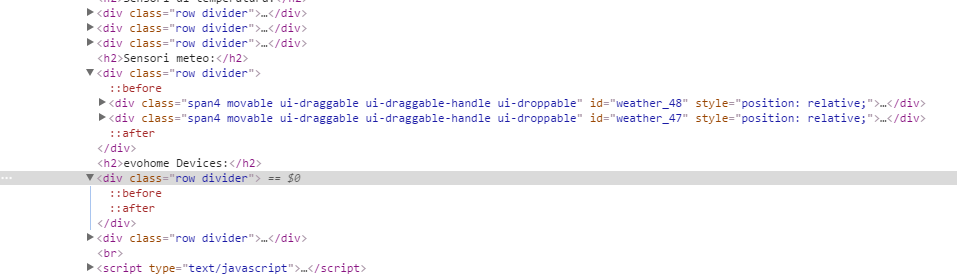

Hi stlaha,
I've tried to choose a different template and also tried to set "Compact" but nothing. :cry:
I've found the header block, but it's the same H2 used for the other headers.
