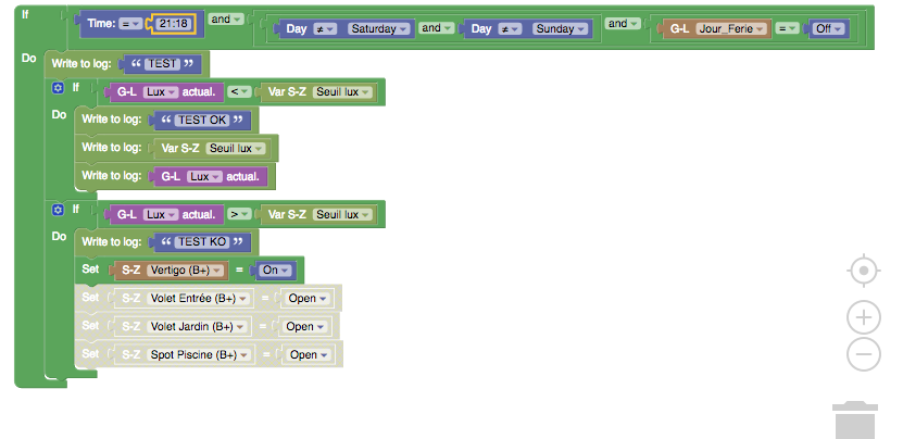

I've this blocky :
Capture d’écran 2016-12-12 à 20.41.27.jpg (99.25 KiB) Viewed 871 times
It compare a Lux devices to a user variable (set to 1500)
Lux is at 0 value (it is the night)
here is my log :
2016-12-12 20:41:00.484 EventSystem: Event triggered: 999-test_1
2016-12-12 20:41:00.485 TEST
2016-12-12 20:41:00.486 TEST OK
2016-12-12 20:41:00.487 1500
2016-12-12 20:41:00.487 0
2016-12-12 20:41:00.488 TEST KO
2016-12-12 20:41:00.529 (Domoticz RPI B+) Lighting 2 (Vertigo (B+))
I don't understand why I have the IF and the ELSIF debig log (and all other actions) ?

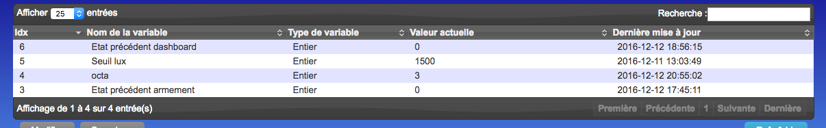

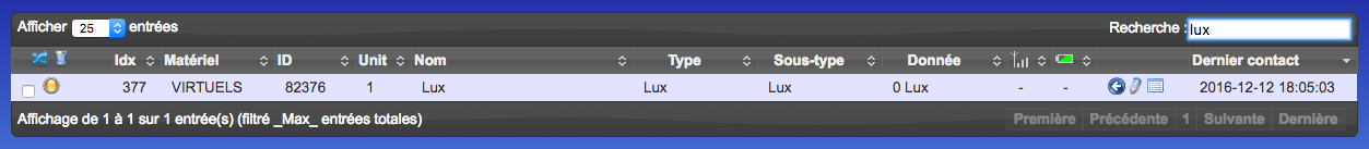

why the comparison between my lux sensor and my user variable if TRUE in the 2 cases ?

Hello
no this blocky gives the same result :
Capture d’écran 2016-12-12 à 21.18.58.png (93.7 KiB) Viewed 854 times
2016-12-12 21:18:00.481 EventSystem: Event triggered: 999-test_1
2016-12-12 21:18:00.482 TEST
2016-12-12 21:18:00.482 TEST OK
2016-12-12 21:18:00.483 1500
2016-12-12 21:18:00.484 0
2016-12-12 21:18:00.485 TEST KO
2016-12-12 21:18:00.526 (Domoticz RPI B+) Lighting 2 (Vertigo (B+))

Re: Strange IF DO ELSEIF in blocky ?
Post by StanHD »
Sorry, I think I was confusing you. You now have more nested "if" blocks. You should only have 1 "If" with multiple "Else If" blocks.

You're right it works :)
