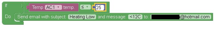

I have just started with Domoticz. I wrote a Blockly event which works and sends an email when the temperature is below a certain point.
Only problem is that it sends the email every minute, which is a bit tiresome and is filling up my mail box.
Graphic of the event script is here:
Could someone give me some hints on how to make it run the test every hour please.

Why using a script when you can setup the same with the notification option on the temp device.
than in Settings/Configuration/Notification you can set the period by which the notification is repeated

Thank you so much. I am still a beginner. I didn't know that this facility existed. It works perfectly!
