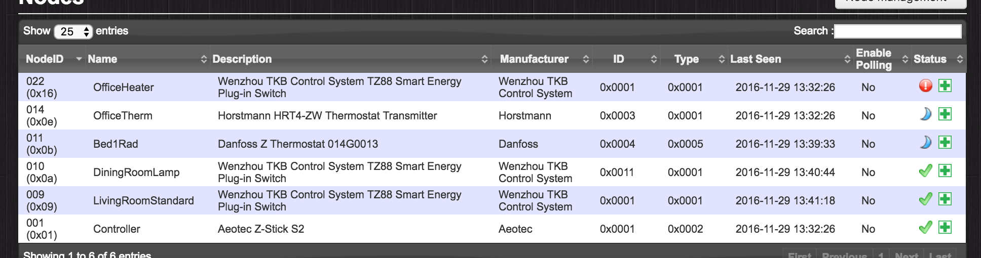

Device 22 has been behaving nicely for over a week. It's permanently powered, as are its neighbouring switches, and is working quiet nicely with device 14, the thermostat.
Suddenly, this morning, it's marked as DEAD.
However, look at the Last seen time. It's still sending updates that are being received by Domoticz. The snapshot was taken at 13:42 and taken after a reboot.
I give up.

start healing your zwave network and wait few hours...
I had the same problem with an AEON Switch that results dead mut it was working fine...
I made the heal and it came back

Thanks for the advice. Healing made no difference.
I could remove and re-add all the devices, but this is not a realistic option in the long term. I've already done that twice to cover earlier problems. The root of the problem seems to be that either: a) the Z-Wave protocol itself is inherently unreliableI, or b) the implementation in the Aeotec and/or Open Z-wave is unreliable.
If you create a reliable network (in the sense of surviving untouched for more than a few days), then the system, by definition, cannot be relied upon and is just another experimental technology that is too fragile for real life.
