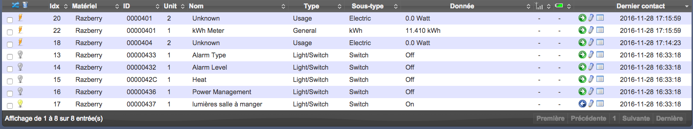

Hi, I've made my first install of fgd212 dimmer controlled by a GPIO razberry-zwave controller and included in domoticz server.
my aim is to switch on/off remotely 4 lamps in my lunch room.
the fdg212 dimmer is connected to a bi-stable wall switch in 2-wires mode.
i can see 8 devices after the inclusion, but none can manage the lights ! (see the joined picture)
when i click on each light/switch type device, i get the message "Error sending switch command, check device/hardware "
in domoticz log file i can see this message :
"Error: OpenZWave: Internal Node ValueID not found! NodeID: 4 (0x04), instanceID: 55"
when i use the physical wall switch to light on/off the lamps, the lights work perfectly and what is stranged is that, i can see after some minutes
the values of electrical consumption and also power measures changing (passing from 0.0 watt to 129 watts).
so what is it going wrong ? what is the right device to use to control the switch (just to light on/off) ?
Capture d’écran 2016-11-28 à 17.20.51.png (127.08 KiB) Viewed 401 times
