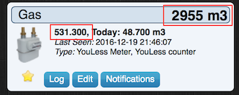

I have the Youless gas sensor since a few days and have the same issue (version 3.5877). Changing the number of pulses/m3 in the Youless configuration doesn't help either.
It would be nice if this could be fixed, the usage in Domoticz is now 10 times higher than real. Besides this the Domoticz panel shows the current usage as m3 while the Youless displays the usage in l/u. 2955 m3 is the amount of gas I am using in 3 years.
Two screenshots to illustrate the issue.
- Domoticz panel.png (50.04 KiB) Viewed 1126 times
- youless reading.png (32.51 KiB) Viewed 1126 times

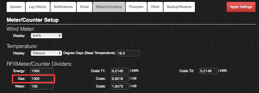

I finally found how to fix the decimal position of the youless gas sensor. In the Meter/Counter tab of the Settings page you can set the conversion of the input. In my situation I had to change the setting from 100 to 1000. Now the Youless reading is correct.
- setting_meter.png (253.72 KiB) Viewed 979 times
