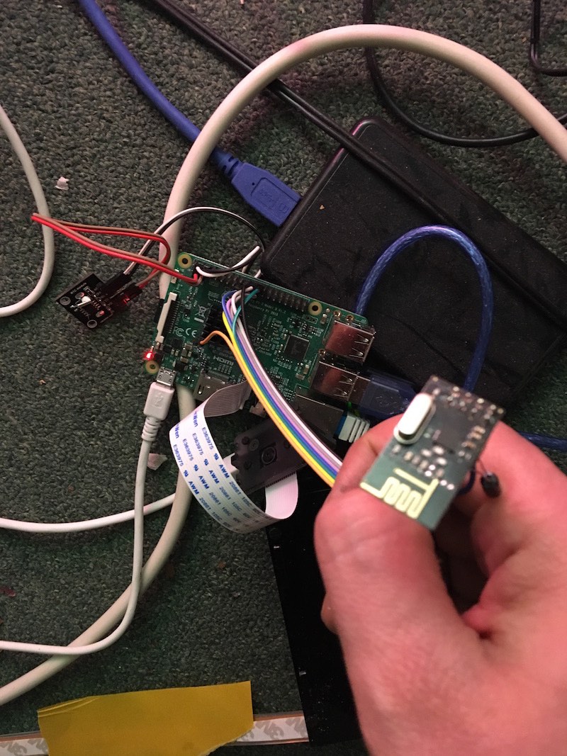

This a photo of an old test version, with the cheapest radio I had (80 cents)...
and I moved the ground and power pins... to make room for a rtc...
also note that a rtc which you see hanging on the left side costs between 80 cents and 3 euro (make sure battery is included)....
if you search on aliexpress using "rtc raspberry pi" you will find rtc with ready made shield for the pi... (note: not like on this picture, it has no shield...)
