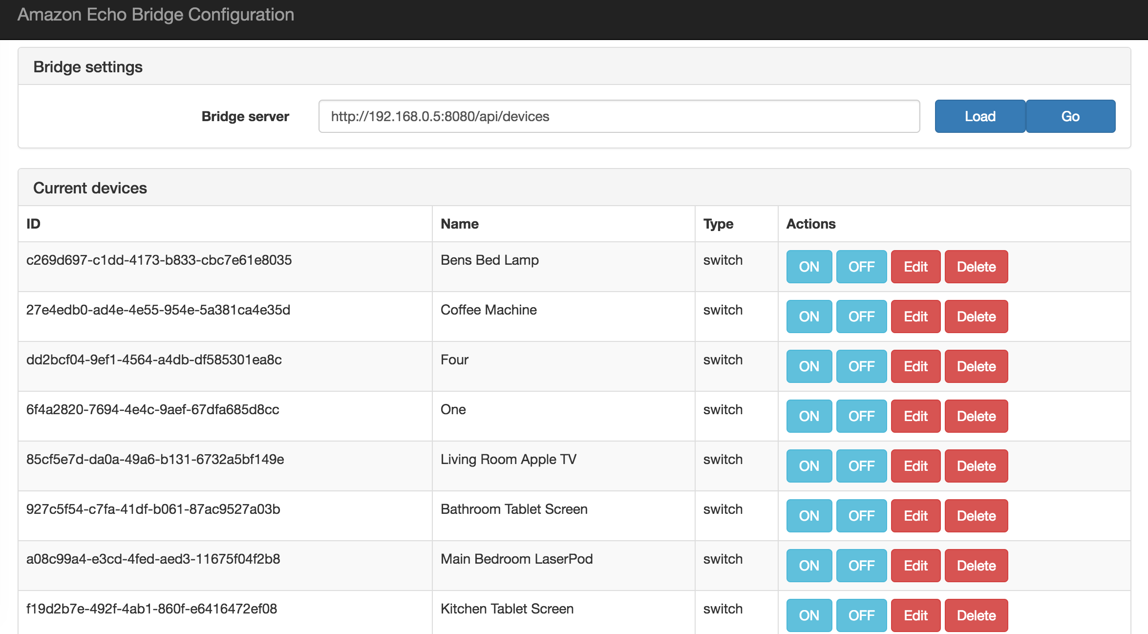

This script gets all Domoticz devices, groups / scenes and loads them into EchoBridge for verbal control with Amazon Echo's.
I like to use EchoBridge because I can say "Alexa turn on one" (which is also Bens Bed Lamp) instead of using a skill in which I'd have to say something like "Alexa tell Domoticz to turn on bens bed lamp".
Screen Shot 2016-11-18 at 2.35.00 pm.png (314.96 KiB) Viewed 588 times

In regards to EchoBridge this is the command options I use when running it (I run it in a screen session, the pkill in the script is just searching for my screen session which happens to be named "EchoBridge" and terminating it):
java -jar -Djava.net.preferIPv4Stack=true amazon-echo-bridge-0.4.0.jar --upnp.config.address=192.168.0.5 --emulator.portcount=8
Note the emulator port section which increases the maximum number of devices (to 200) from the default 75 in EchoBridge 0.4.0, this may be required if you have a lot of devices in Domoticz.
