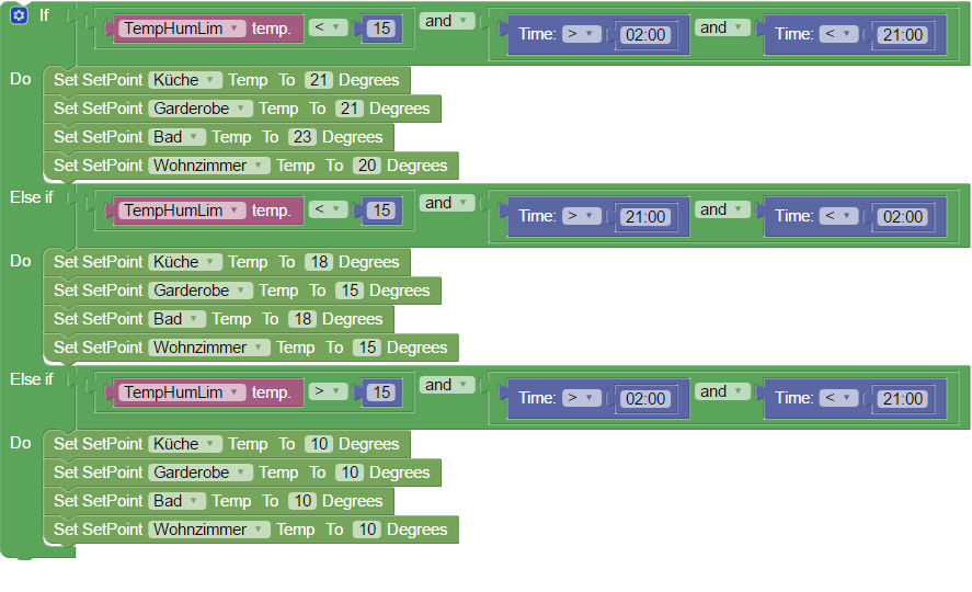

disasterman
Joined: Wednesday 26 April 2017 18:48
Re: Am I doing this right?
Post by disasterman »
I tried many Heating Thermostates and for my way the best are the Devolo.
To change Automatic the Setpoint, i combined it with the Outdoor Temperatur.
