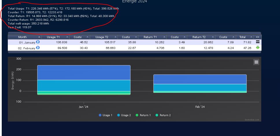

Does this mean the readings in the diagram(s) just continue from the old meter to the new meter?

njlammerts wrote: Thursday 22 February 2024 14:40 Does this mean the readings in the diagram(s) just continue from the old meter to the new meter?
yes, if you follow the instructions
