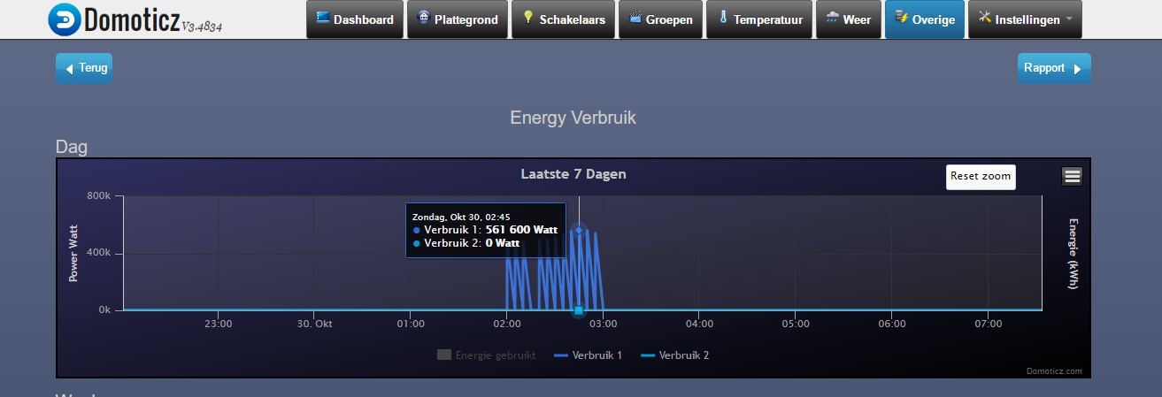

Whom else have seen strange values on their smart meter from 2am till 3 am this morning (wintertime change). The meter itself also has recorded it as power usage, so it is not a glitch in Domoticz. Very strange spikes up to 500kW!
ScreenHunter_73 Oct. 30 08.37.jpg (64.3 KiB) Viewed 1291 times

Yes, I have this yoo. Spikes to just under 400watt for 1 hour long just like in your picture.

Duci wrote:Yes, I have this yoo. Spikes to just under 400watt for 1 hour long just like in your picture.
It is 400k!!! calculate that for a few seconds and the amount of spikes and you have a few (10's of) kWh extra in one hour!! who benefits from this, it has been recorded by the meter itself as well!

If you searched the forum, you would have found out that this is related to the daylight saving time bug we have (and should be fixed some day)
This happens to all sensors
Shift-click with the mouse on them will remove them
