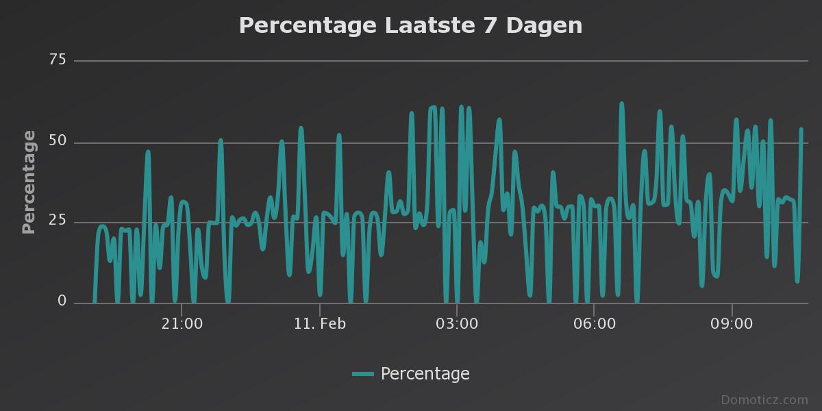

To check the temperature and humidity in the space under my house, I 'planted' and installed a 'fork'-probe and a DS18b20-probe in the soil (see webpage), with the 'fork'-probe connected to the analogue port of an ESP8266 with ESPEasy.
Precalibration reveals that 100% water ~500 units and 0% water ~1000 units.
With formula (1024-%value%)/5 that results from the ESP8266 in an output signal of approx. 0 till 100.
The picture below is the output graph in the past hours as log-picture by Domoticz: if feeling by hand the sandy soil is 'semi-dry'.
The reported values show heavy fluctuations: any explanation?
Anyway the registration supports the already assumed functional performance of this 'fork'-probe-concept:
sufficient for rough checking whether the plants really need water, but not much better.
