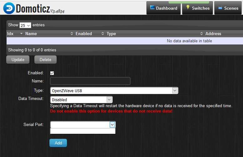

I am then able to log in to the Domoticz web interface. I try to add a new hardware, and selects OpenZWave USB in the list. But there is nothing in the "Serial port" box, as seen in the attached screenshot.
Have I done something wrong so far? I have read that the symlink should not be necessary for newer versions of Domoticz.

- dump1.PNG (104.66 KiB) Viewed 4809 times
