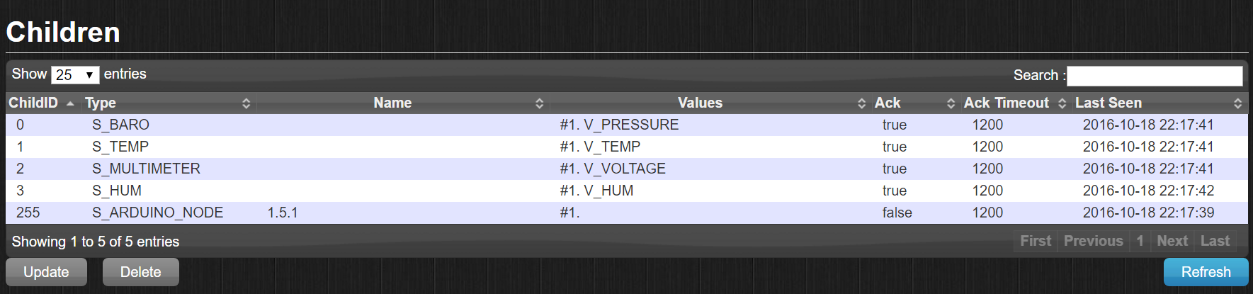

My problem is that when it is raining I get Humidity above 100%(i know not correct) but it seems that DZ is not register this value so I don't see Temperature and Barometer either. At the moment Humidity is 104%, it is sent to DZ but DZ is not updating any values, except BatteryVoltage and BatteryPercent because they are not in combination with Humidity

See attached picture, it says that Child Humidity is correct received.
Why not set the Humidity value to 100% if it is above 100 or at least update the values that is inside limits, in my case Temperature and Barometer
