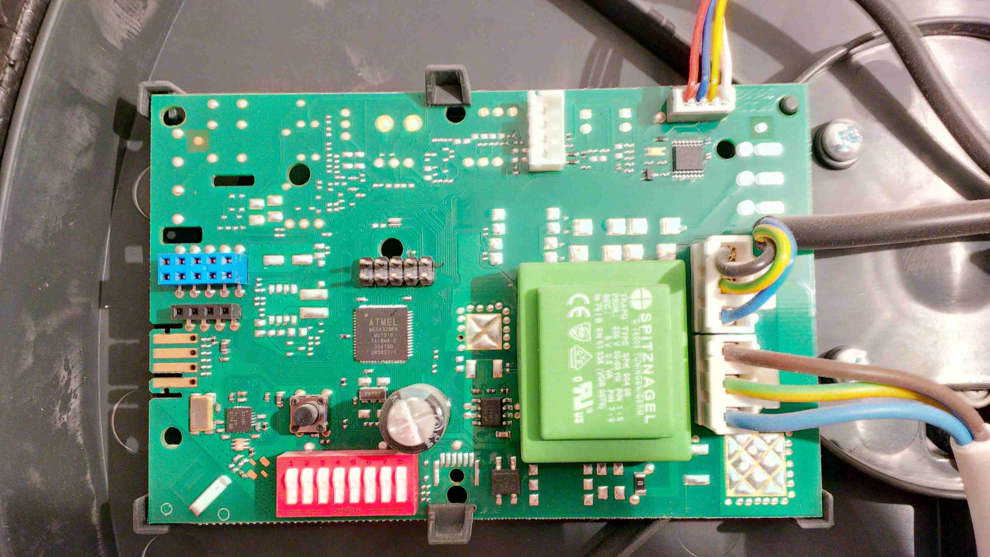

Post by Bighouse »
Holland wrote:A question on 868 hardware; FSK or OOK
Trying to set up communication between an Orcon home ventilationsystem (MVS15). Frequentie 868,3 MHz and on the PCB of the Orcon there is a CC1101 chip visible.
Just wondering, which Aurel 868 MHz module is the preferred for the above system; The Aurel 868 MHz FSK Tranceiver module or the 868 MHz OOK Tranceiver module?
Already got something working? I have this module in my appartment:

Post by Templar »
Can you make a picture of the PCB? It looks like an Itho Daalderop RFT CO2-sensor 230V.
http://www.ithodaalderop.nl/sites/defau ... 20230v.pdf
The PCB may look like the one on this page: http://www.progz.nl/blog/index.php/2014 ... ft-part-1/ If that is the case it most likely uses (a variant of) the Itho RFT protocol https://gathering.tweakers.net/forum/li ... /1690945/0

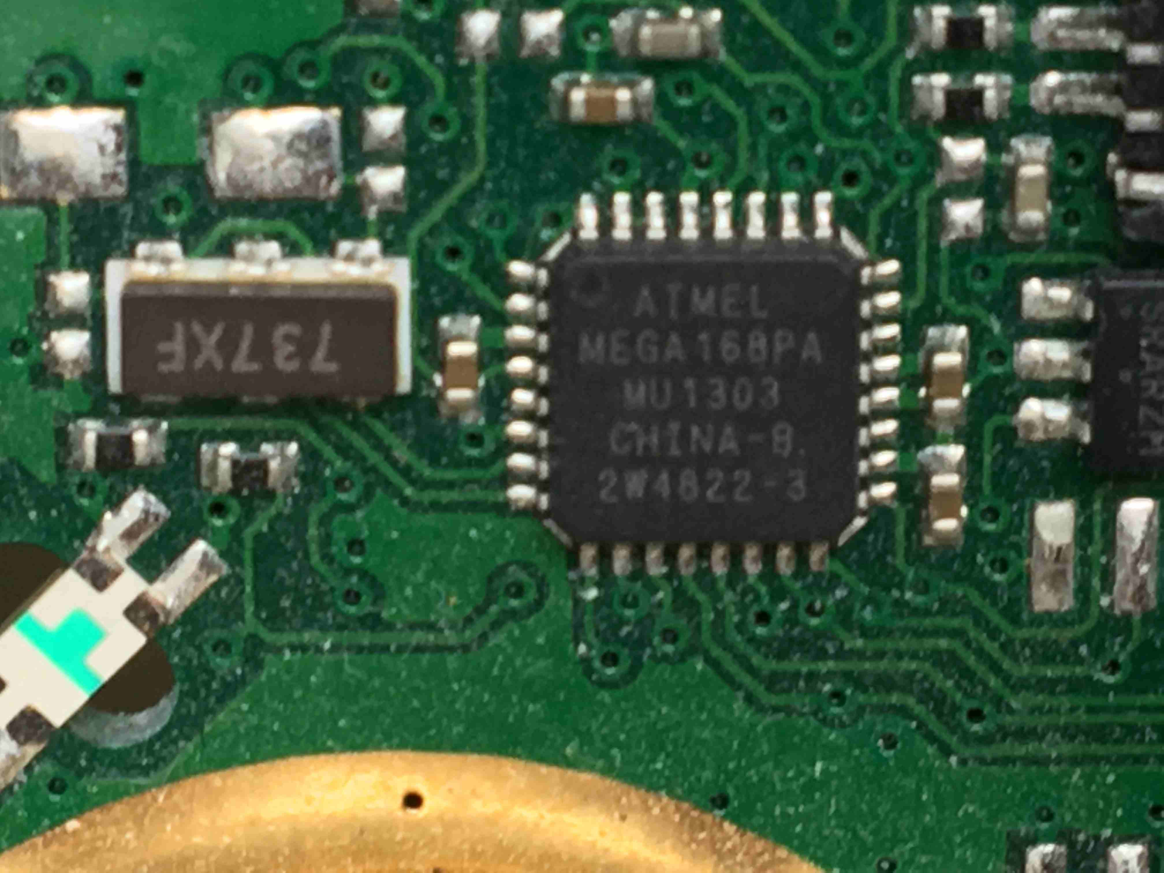

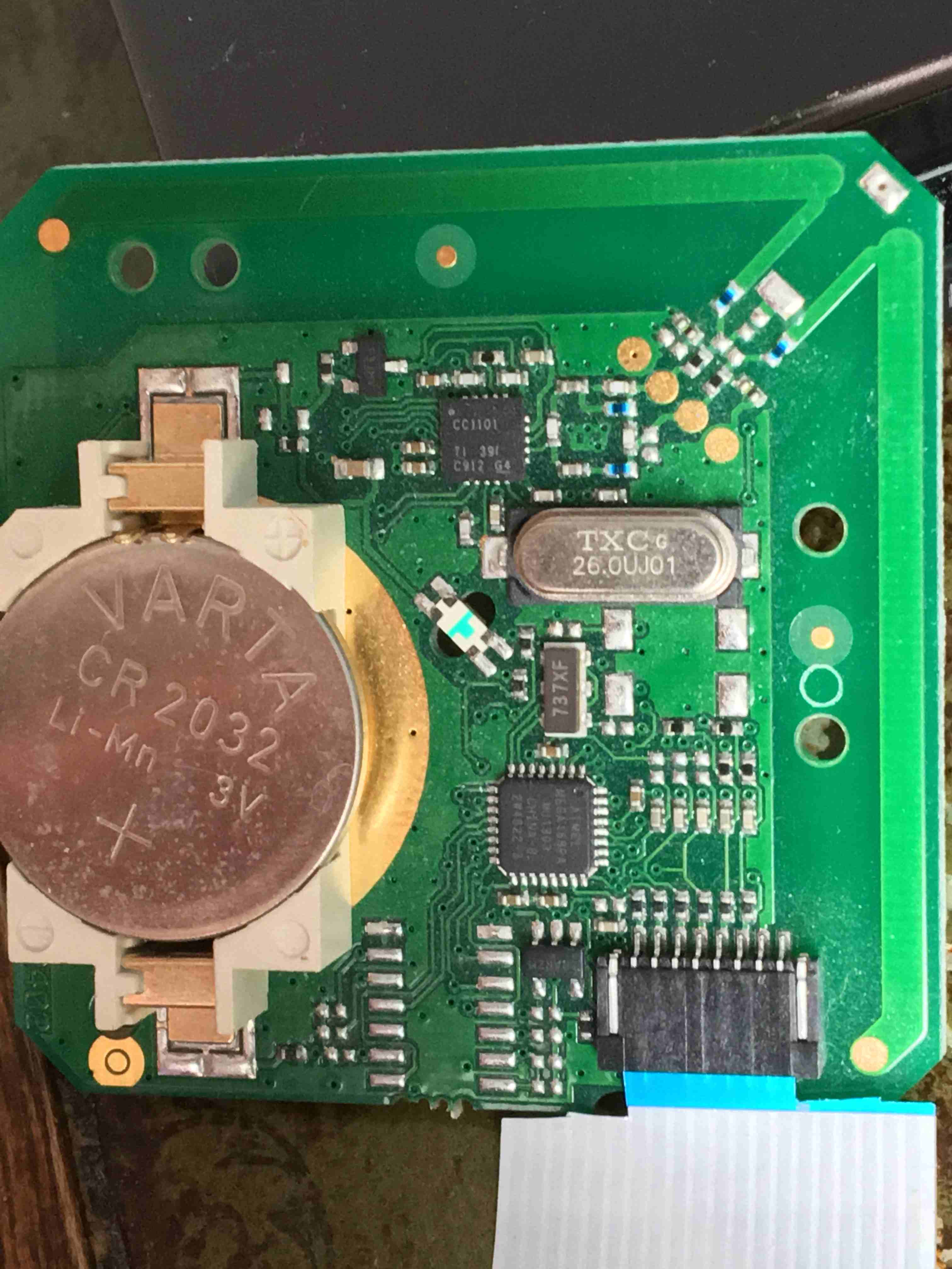

Post by Holland »
@Templar,
See below a number of screenshots.
There are quite a number of differences, most relevant is the 868MHz RF chip, in the Orcon remote control that's the CC1101 and in the Itho CC1150. Also the CPU is different, same brand, but different series.
Could it be the case, that the difference are minor, and that it still should work using the Itho protocol?

Post by Templar »
Holland wrote:@Templar,
Hmm okay, the Orcon can also receive information. Too bad we can't compare it with an Itho CO2 sender. However, I wouldn't be surprised if it would match. And I assume the Itho RFT sender and CO2 sender share the same protocol for convenience..
