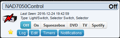

In the meantime I made a Selector switch for the NAD in which you can turn it on/off and directly select the input, with a separate dimmer switch to control the volume (I then picked up a Homey, spent a couple of frustrating nights wondering whether I should return it until I figured it's actually pretty cool but completely different from domoticz, with a different learning curve... I have not yet gotten around to connecting homey with domoticz to control the NAD amplifier...).
Anyway, the Selector switch is pretty useful.

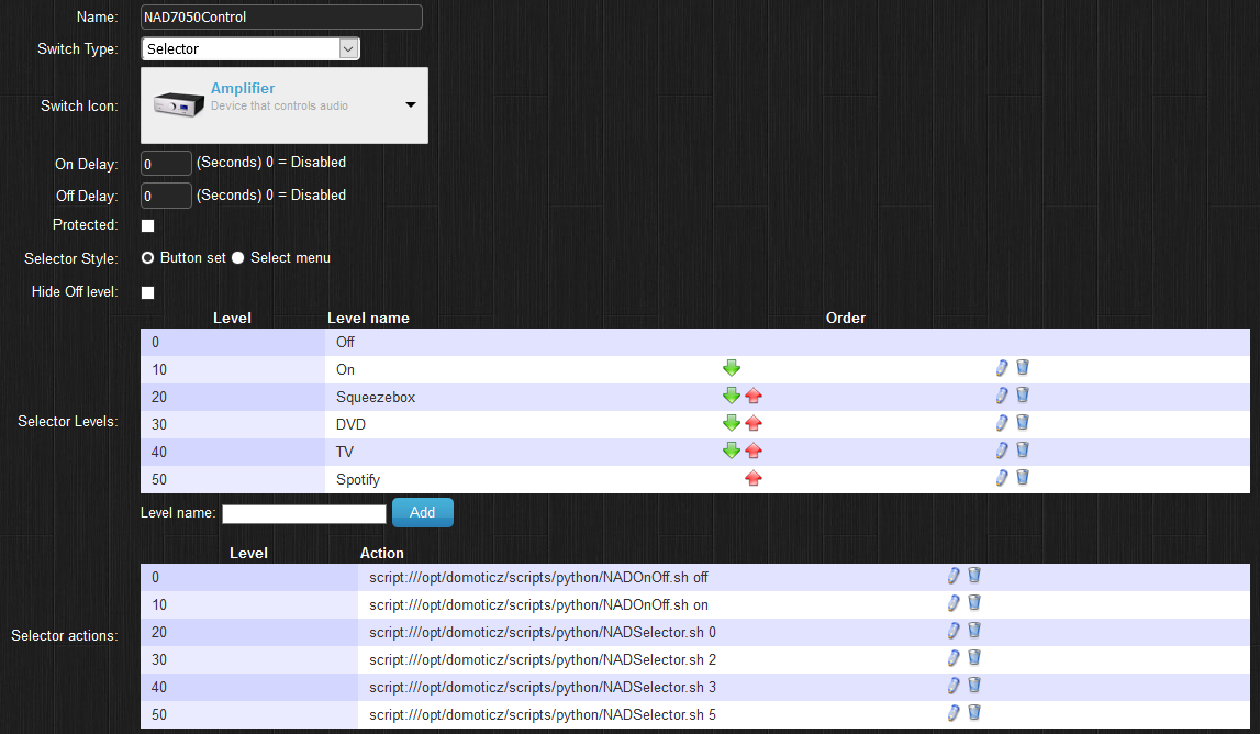

The following screenshot shows how I setup the Selector switch:

Here's the input selector script (I called it 'NADSelectDirect.py'). Any of the 8 inputs can be selected/added, I only use four:

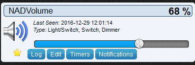

I just had a look at the Volume. I am not entirely happy with it, although the dimmer swich now does control the entire range (0 - 192 in the volume script), the steps are small on the low end of the dimmer scale, and relatively big on the high end of the scale, but I guess it's good enough. More often than not I use the volume control in the Spotify or iPeng app.
Here's the volume dimmer switch:

As a sidenote, last week suddenly Spotify connect stopped working... Airplay was fine, but Spofity connect only worked intermittently. I thought I had broken the amplifier, I did a reset, downgrade, upgrade, no difference. In the end it turned out Spotify had an issue on their end, many people had the same problem with all kinds of Spotify devices! :o Fortunately Spofity addressed the issue and everything has been fine since :)
