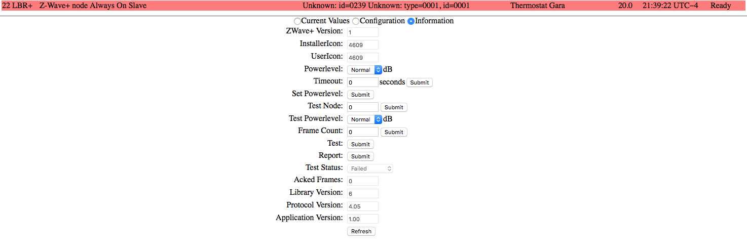

I bought this week a Z-wave thermostat "Stelpro Ki stzw402+", and the integration in Domoticz is very weird. I see the temperature but I can't change the mode or the set point in Domoticz. Is there a solution for a better integration ?

Your device is Unknown to Domoticz, that's why you don't find any options to manipulate.
Are you on stable, or the beta? Because I think the beta contains the relevant openzwave xml to operate this device. If you're on stable, then switch to beta, remove the device, and readd it. After that you should see some new devices at your device tab, one of them is the setpoint - which you can easily manipulate (I don't have this device, but have Danfoss thermostats and I'm pretty sure the logic is the same here).

I switch to beta and its works! Great! Thank You !
