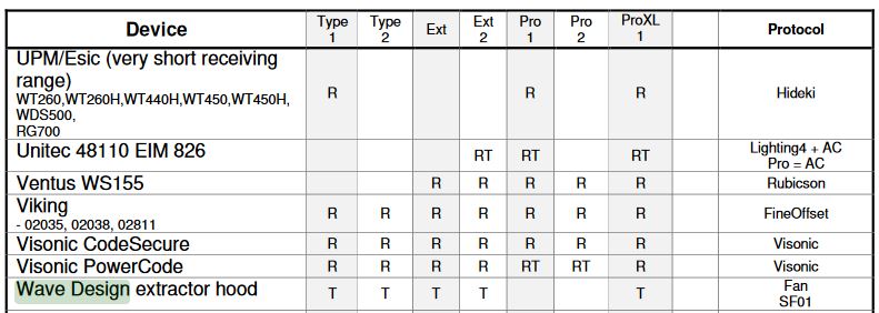

Edit: Maybe i have to update the RFXtrx433XL from firmware 1034 to firmware 1043 to use this special option.
On page 10 of the current user manual is written:
Specials
Wave Design extractor hood
On page 19, so receiving is not possible, sending should be (but how):
