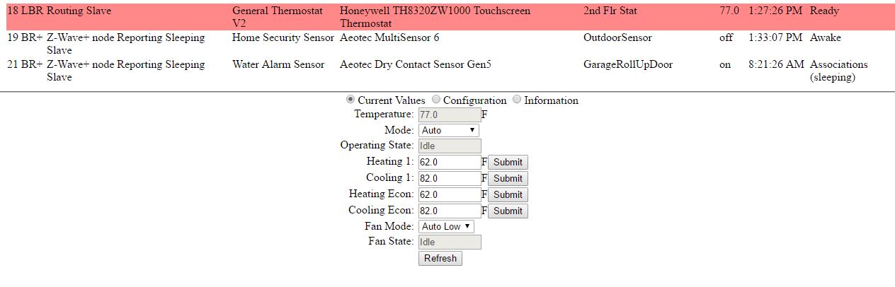

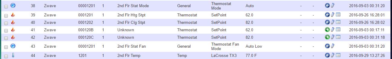

I posted a topic under Z-Wave concerning a Honeywell TH8320ZW1000 thermostat and getting all the values presented in the OpenZwave Control Panel available in Domoticz. I can see values in the control panel that i would like to have visible in Domoticz such as Operating State and Fan State.
Since this appears to be an issue in Domoticz (my apologies if my assumption is incorrect), my question is how do i go about getting this resolved?
Thank you for a great product and thank you for any assistance with this issue.
Here are a couple of screenshots i took to help visualize what i'm seeing on my end.

I have the same issue with the same thermostat. I would love to be able to see fan state within domoticz, currently openzwave control panel can.
