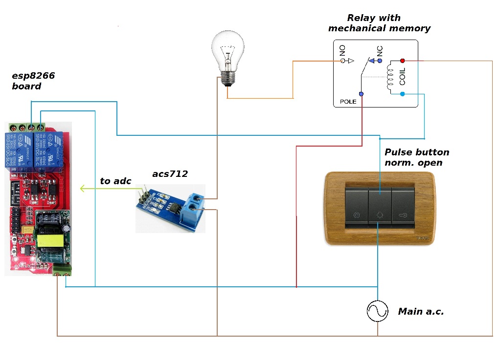

Now i want to add more features to this my first sample and i have some trouble , i'll explain. In my house all lamp light are 220Vac and they are controlled through relay with mechanical memory. It sounds like when you press the button on the wall (pulsing button, not on/off switch) it excite the relay that switch on next position and turn on the light. The simplest relay has only two position (on and off) there are also relay with more position that make combination of the light (es four position).
I want to setup with espeasy + domoticz a lamp device on the dashboard where the status is given from adc read of esp8266 where i connect a current sensor to voltage converter (like acs712) and the light command can change dinamically, so if current flow is less than a minimal costant value the lamp is off so if i click the lamp it has to send th on command, while if the current is actually low it sound like the light is off so if you click the lamp icon on the dashboard it has to send the "on" command.
I attach a schema of the system i would to make, it is the simplest way to mantain the old electrical scheme working also if domotic or esp8266 are blocked or burnout.
I've read that both espeasy and domoticz can be customized with script, but at the moment i've not idea how to make it, so any help on what to study to make this will be appreciated.

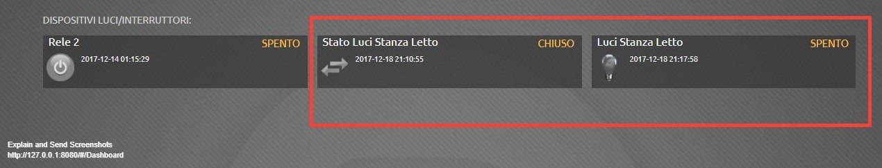

I've a similar setup.
EspEasyR120 on Wemos D1 Mini + 5v TTL Optocoupler + 5v Relays.
I can send pulse to relay and read 220v status with a virtual switch
Is there a Domoticz dashboard widget that report switch status Reading a virtual switch?
Now I have 2 widget and I Need only One instead...
Best Regards
Best Regards

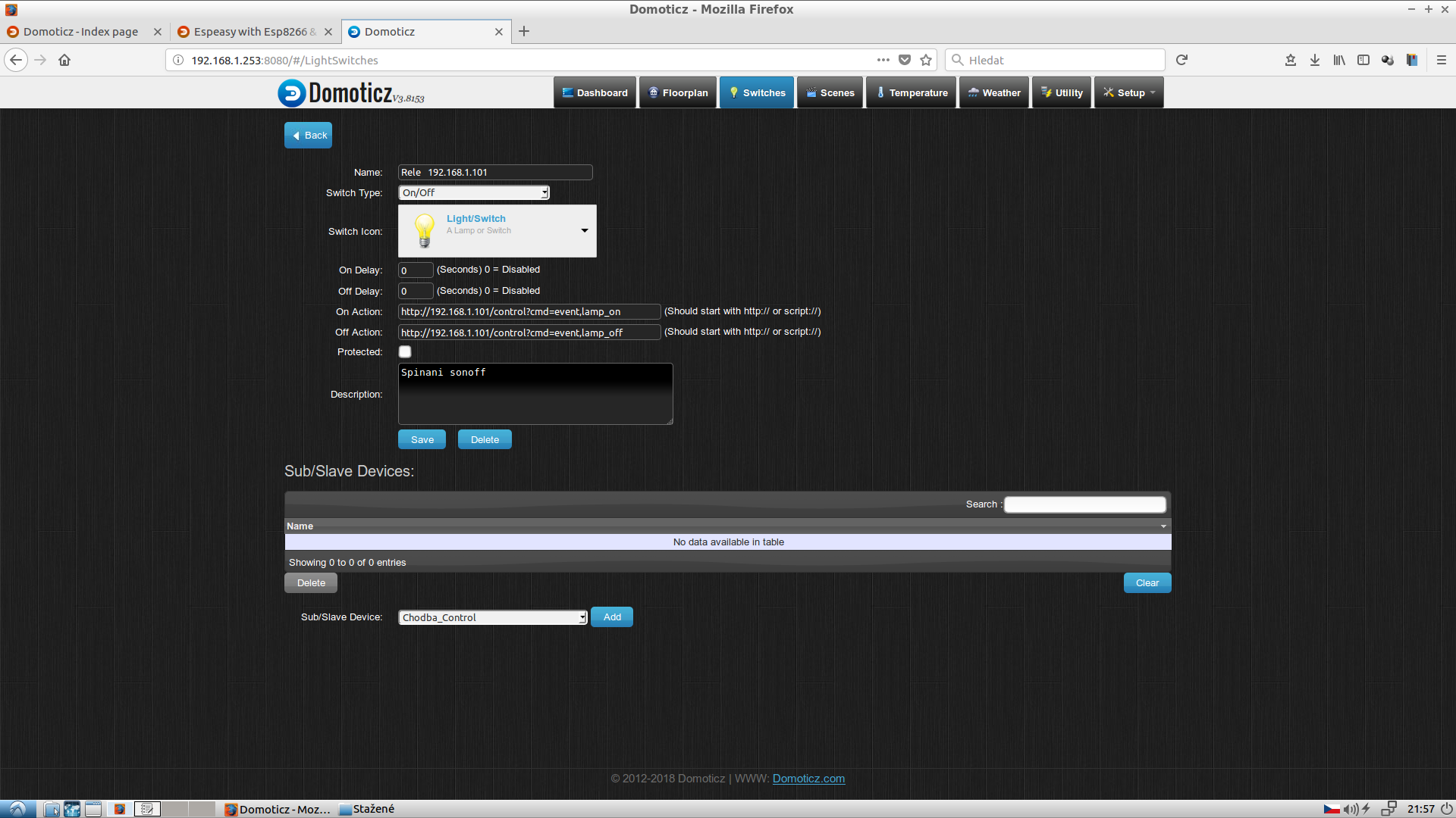

For example my setup:
1) Domoticz with switch defined
2) ESP01 at x.x.x.101 with relay (GPIO12), LED (GPIO13) and push button
3) ESP02 at x.x.x.100 with Push button
.... And you can add other ESPEasys with buttons
I want change relay status with each press of button on ESP01 or ESP02 and report this to state of switchto Domoticz.
Change relay status from click on switch in Domoticz.
First - define dummy switch (its idx=19 in my case ) and actions for ON and OFF in Domoticz
Send event to ESP01 On ESP01define switch SW01 and write rules:
On ESP02 define switch and with each its press send event "lamp_change" to ESP01
On others eventually wifi switches do the same.
In this configuration, if Domoticz is down, and wifi works, you can use all switches.
If wifi is down, you can localy drive relay like normal wall switch.
on lamp_on do
gpio,12,1 //relay
gpio,13,0 //led
endon
on lamp_off do
gpio,12,0
gpio,13,1
endon
on lamp_change do
if [rele#Switch]=1
event,lamp_off
SendToHTTP 192.168.1.253,8080,/json.htm?type=command¶m=switchlight&idx=19&switchcmd=Off
event,lamp_on
SendToHTTP 192.168.1.253,8080,/json.htm?type=command¶m=switchlight&idx=19&switchcmd=On
endif
endon
on SW01#Switch do
event,lamp_change
endon

But my "lamp_on" and "lamp_off" actions only sets gpio pin - nothing is send to Domoticz in these actions.
So if Domoticz sends this command again, nothing happens, because pin is set previously.
I think, there is no other solution, if you want indicate state of relay and control relay by one icon in the same time.
If you only want indicate status, do not write any commands to "OnAction" and "Off Action" boxes in Domoticz
and maybe choose different switch type - "contact" for example to not allow user change status by clicking on it.

Hello,kimot wrote: Saturday 06 January 2018 22:22 For example my setup:
Send event to ESP01
On ESP01define switch SW01 and write rules:On ESP02 define switch and with each its press send event "lamp_change" to ESP01Code: Select all
on lamp_on do gpio,12,1 //relay gpio,13,0 //led endon on lamp_off do gpio,12,0 gpio,13,1 endon on lamp_change do if [rele#Switch]=1 event,lamp_off SendToHTTP 192.168.1.253,8080,/json.htm?type=command¶m=switchlight&idx=19&switchcmd=Off else event,lamp_on SendToHTTP 192.168.1.253,8080,/json.htm?type=command¶m=switchlight&idx=19&switchcmd=On endif endon on SW01#Switch do event,lamp_change endon
