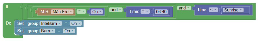

This is my Blockly This is Timers for Barn Scene and today Sunrise/Sunset time This is the Log for Barn Scene Yesterday(15/9) Sunrise/Sunset was 06:41 and today(16/9) it is 06:43 but why is the Timer setting OFF for Barn Scene at yesterday time.
I am using "Before Sunrise 00:00", does it mean yesterday Sunrise time or should it be Today exact when Sunrise is? I will try to set After Sunrise 00:00 and see what happens.
