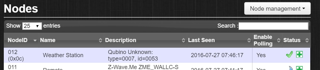

I'm having some problems with Qubino Weather Station ZMNHZDx.
In config the ZMNHZDx.xml exists, manufacturer_sprcific.xml includes:
<Product type="0007" id="0053" name="ZMNHZDx Weather Station" config="qubino/ZMNHZDx.xml"/>
In Nodes: <see attachment nodes>

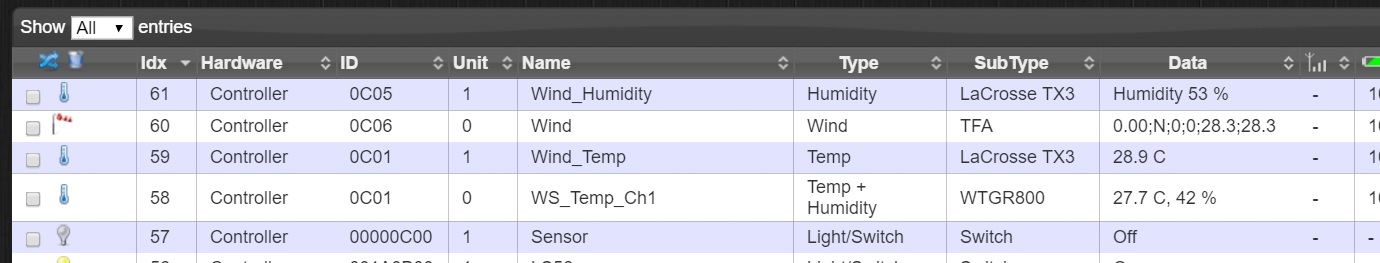

The devices that i have been abel to find during my struggle is:<see attachment devices>

- Dont receive direction from anemometer
- Dont receive data from thermo-hygro sensor on channel2
- Dont receive data from Rain sensor.
