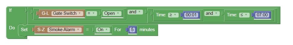

I do not know Lua so tend to use Blockies to write the basic scripts in my home Domoticz system.
I have a KD101 smoke alarm connected to my RFXcom and visible in Domoticz. I can switch it on and off in the Switches screen. I also have a wireless door contact on my shed door which is visible within RFXCom/Domoticz.
I am trying to create a simple blocky that sounds the smoke alarm for 5 minutes if the shed door is opened between 00:00 and 07:00. The attached is my blocky script that i am trying to implement.
Currently the smoke alarm does not sound if the shed door is 'open'. Also, when I do sound the KD101 it only alarms for approx 10-15 seconds before remaining in 'panic' mode and requires resetting to 'normal' mode.
Any helpers?
Many thanks

- Blocky.JPG (28.92 KiB) Viewed 1169 times

Can you change Set smoke alarm = "On" to Set smoke alarm = "Panic"?
The duration of the alarm is a known issue. I have one too and can't see that anyone has been able to get them to sound continuously when artificially set into panic mode.

Great, I will try that change an advise
