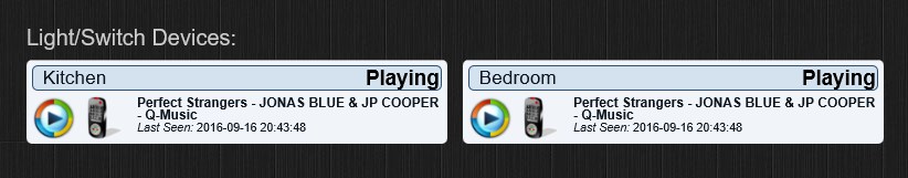

Re: Denon Heos speakers working with domoticz
Posted: Friday 16 September 2016 20:59
by Sneezydevil
I got some stuff working now, can't control them yet though.
HEOS Implementation Start.png (33.75 KiB) Viewed 10426 times
HEOS Implementation Start 01.png (28.93 KiB) Viewed 10426 times

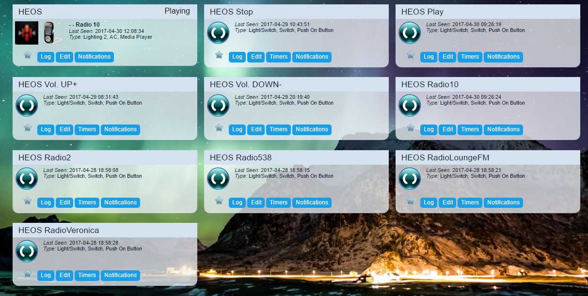

Posted: Sunday 30 April 2017 12:31
by westd001
Mabye this is interesting for some users that want to control there HEOS speakers via Domoticz. In my configuration my HEOS speaker isn't working via Domoticz (only start, stop and pause buttons are working OK). The other buttons (for example Favorites button) result in a "2017-04-30 12:01:37.623 Error: HEOS by DENON: Command: 'Favorites'. Unknown command" error.
I used the scripts from steven84 and made some changes.
Here is the layout of my screen :
HEOS in Domoticz.JPG (149.69 KiB) Viewed 8978 times
For every button I made a dummy switch/push on button with the following "on" commands :
script:///home/pi/domoticz/scripts/heos/stop.sh
script:///home/pi/domoticz/scripts/heos/play.sh
script:///home/pi/domoticz/scripts/heos/volume_up.sh
script:///home/pi/domoticz/scripts/heos/volume_down.sh
script:///home/pi/domoticz/scripts/heos/radio10.sh
etc.
For example the code of the play script (see the zip file of steven84):
PS: For play, pause, stop, volume up and down you don't need to be logged in.
#!/bin/sh
. /home/pi/domoticz/scripts/heos/config.conf
echo "heos://player/set_play_state?pid=$PID&state=play\r" | nc $HOST $PORT
To be able to select presets via favorites you need to be logged in.
For example the code of the Radio10 script:
#!/bin/sh
echo "heos://system/sign_in?un=<username HEOS account>&pw=<password HEOS account>\r" | nc $HOST $PORT
sleep 1s
echo "heos://browse/play_preset?pid=$PID&preset=1\r" | nc $HOST $PORT
The number of the preset (preset=1) corresponds to the first, second, third etc. station in your favorites list.
Much more HEOS commands can be found in the CLI description on the DENON site.
Have fun with it.
JJ
