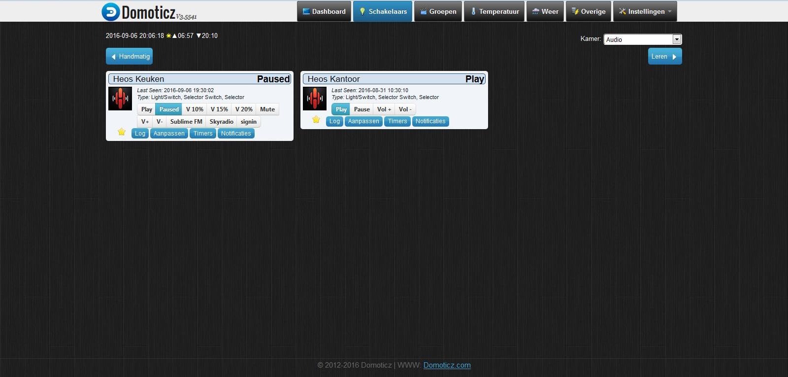

I’ve managed to get Denon HEOS speaker to work with domoticz. I’am no coder so the way I did it is not nice but It works and I hope that coder will pick this up and get it right.
The Heos speakers have their own Telnet network which communicates on port 1255. The shellscript are giving commands en closes with a telnet cmd. For now a took just a few commands. I will post the API document for more commands.
Putty
• Install/Open putty
• Fill at Host the Heos device IP and set port to 1255
• Give following command in cmd screen:
• heos://player/get_players
The response will be like example below. Important is the PID number. You will need it to command the player.
"name": "'player name 1'",
"pid": "player id 1'",
"gid": "group id'",
"model": "'player model 1'",
"version": "'player verison 1'"
Shellscripts
• Download the Denon HEOS scripts.zip and put in in the scripts location on your raspberry.
• Edit the config.conf file
For example:
HOST=192.168.xxx.xxx
PORT=1255
PID= -133XXXXXX
• Edit path at every .sh file to your own location.

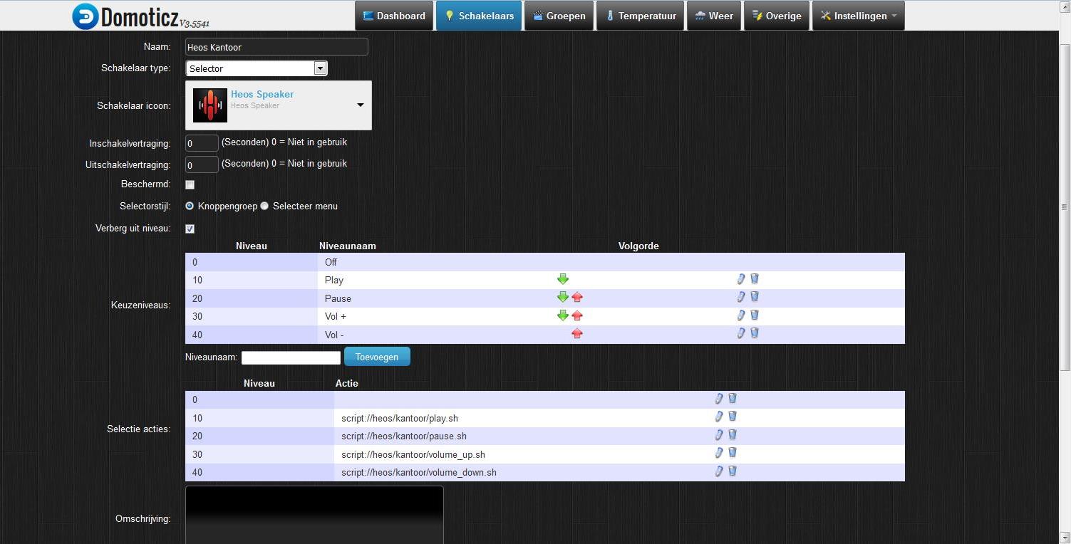

Domoticz
• Add a dummy selector switch with button set
• Make multiple sets en give them names like Play, Pause etc. etc.
• Put script after every levelset.
• And your done.
Next steps
• The device response with a json payload so would be great for the future that the button shows which artist and song the device plays.
• Tunein radio stations listed and playable.
• To implent error handling such as connection timeouts, reconnecting etc. And of course, implement all the API commands and events
API documentation: http://www.eurostar-ostrava.cz/files/01 ... OL_V01.pdf

Mabye this is interesting for some users that want to control there HEOS speakers via Domoticz. In my configuration my HEOS speaker isn't working via Domoticz (only start, stop and pause buttons are working OK). The other buttons (for example Favorites button) result in a "2017-04-30 12:01:37.623 Error: HEOS by DENON: Command: 'Favorites'. Unknown command" error.
I used the scripts from steven84 and made some changes.
Here is the layout of my screen :
For every button I made a dummy switch/push on button with the following "on" commands :
script:///home/pi/domoticz/scripts/heos/stop.sh
script:///home/pi/domoticz/scripts/heos/play.sh
script:///home/pi/domoticz/scripts/heos/volume_up.sh
script:///home/pi/domoticz/scripts/heos/volume_down.sh
script:///home/pi/domoticz/scripts/heos/radio10.sh
etc.
For example the code of the play script (see the zip file of steven84):
PS: For play, pause, stop, volume up and down you don't need to be logged in.
To be able to select presets via favorites you need to be logged in.
For example the code of the Radio10 script:
The number of the preset (preset=1) corresponds to the first, second, third etc. station in your favorites list.
Much more HEOS commands can be found in the CLI description on the DENON site.
Have fun with it.
