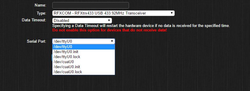

*update: I was able to create the symblink after changing permissions (apparently they changed with a reboot of the jail.
Could now link them together with ls -s /dev/ugen0.6 /dev/ttyU0

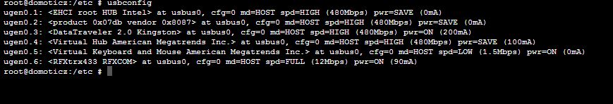

I got the Rfxcom connected and can see it when running usbconfig
However it does not show up in Domoticz

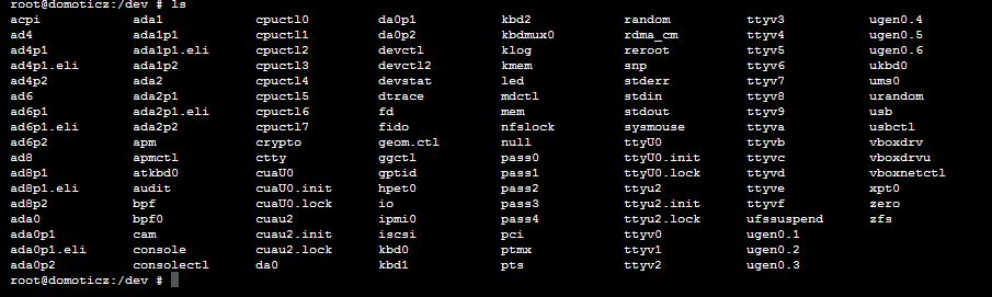

My dev catalog looks like this
As i have looked around i could find that i needed to do a symlink, sadly aim not succeeding.
