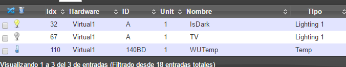

Look, you're absolutely right. I confused the Id with idx. :o :oops:
Sin título.png (12.85 KiB) Viewed 3105 times
Now it works! Well... I feel stupid.
But now, I see that I have two devices with same id. Should that be why I couldn't work with "IsDark" on blocky lately. :?:
It's normal?
