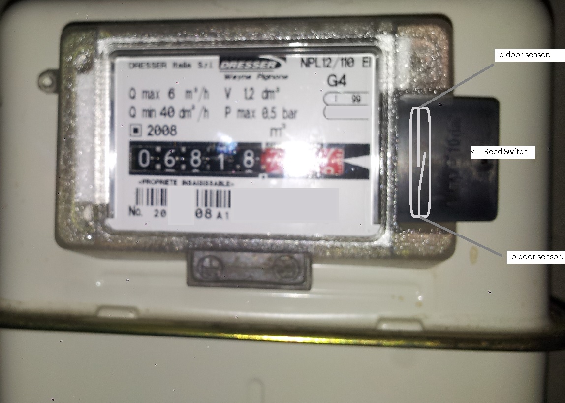

I'm looking to install Domoticz on RaspberryPI to monitor Gas/Water/Electricity consumption with wireless capabilites (433Mhz).

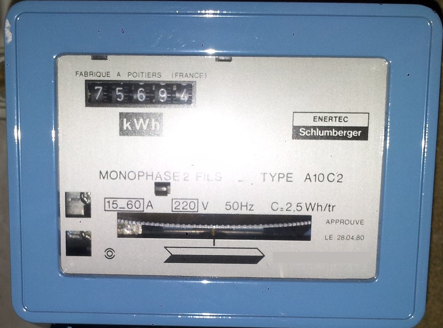

At the moment, I know I need a reed/magnetic sensor for the gas meter, and infrared emitter/sensor for my electricity rotary disc meter.

- Gaz Meter - Reed/Magnetic Sensor
- Gaz_Meter_Reed_Switch.jpg (221.66 KiB) Viewed 1234 times
- Eletricity Rotary Disc Meter
- Electricity_Rotary_Disc_Meter.jpg (171.6 KiB) Viewed 1234 times
