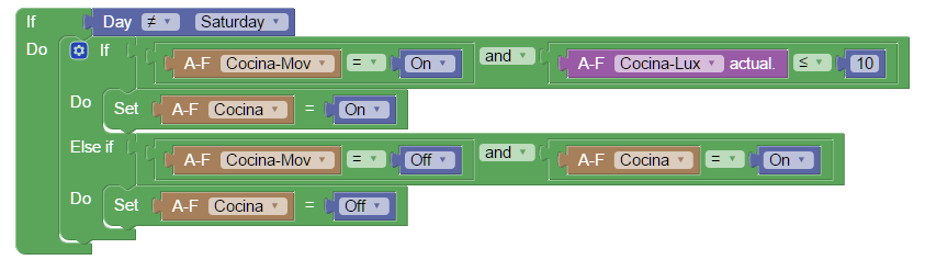

I want that a event wrote with blockly run just in some days of the week. It looks like very easy: an If for check day of week.... but...
I save it as device type. What I want is
if Day is not Saturday {
IF (cocina-mov = on and cocina-lux < 10) THEN cocina = ON
ELSE IF (cocina-mov = off and cocina = on) THEN light = OFF
cocina-mov is a PIR an cocina-lux is for metering lux. cocina is a light
I think the logic is OK, but when movement is detected and light is <10 and it's not saturday controller doesn't send any command
I think the script is correct. It Is saved as device and cocina-mov is involved so it must be triggered when cocina-mov changes, but it's not triggered when cocina-mov changes.
If a delete the checking of weekday the script works fine.

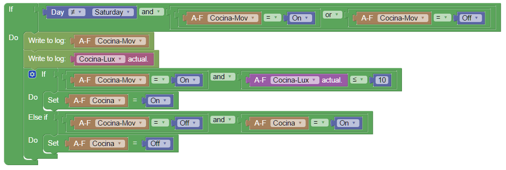

Then I made a change and wrote this blocky, also saved as device
Logic now is
if (Day is not Saturday and cocina-mov has changed){
write to log cocina-mov and cocina-lux
When I go into the room, PIR detects me and I get in log that cocina-mov is ON and cocina-lux is 0, but controller sends an OFF command instead an ON.
It Is also saved as device and cocina-mov is involved in the first IF sentence, now script is triggered but it sends the wrong command, an OFF, it evaluates to false (cocina-mov = on and cocina-lux < 10) althoug it writes in log cocina-mov is ON and cocina-lux is 0.
Why it doesn't work?

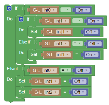

I've made more tests with blockly scripts and i've found that blocky works in a strange way
I see that nested IF doesn't work properly and the script is triggered for every device used in an IF sentence!
And time triggering doesn't work with blockly (it works fine with lua)
Try this example. It uses 3 switches (virtual swtiches) Int0, Int1, Int2
If you turn On Int0 then int1 must change its status (if Off it goes to On and viceversa).
If you turn Off Int0 then int1 and Int2 must goes to Off.
If saved as time triggered event it doesn't work
If saved as device triggered event:
it is not triggered when Int0 goes to OFF, just trigger when goes to ON
If you turn switch Int1 the event is triggered, and if it's ON you cannot turn it OFF
So, how works blockly?
