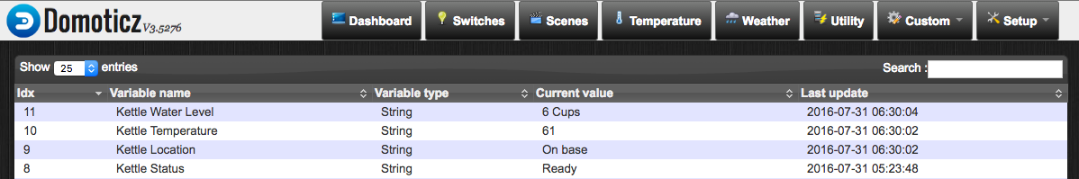

If you use python kettle.py status domoticzsync, you can setup 4 variables in Domoticz and the script will update them if the device status changes. Be sure to set the IDX value for each device in the kettle.py so it knows which variable to update in Domoticz, these are in the "Kettle Domoticz Sync" section of the script.
Screen Shot 2016-07-31 at 6.50.54 AM.png (79.12 KiB) Viewed 4593 times
All the variable types in Domoticz for the kettle should be set to: String

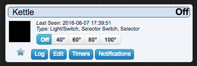

Here is an example Lua script for doing something when a variable status changes (in this case Ready vs Boiling), note that the script MUST be placed in the Domoticz/scripts/lua directory and that the file name MUST start with: script_variable
In this case the full file name I'm using is: script_variable_kettle.lua
You cannot simply place this script in the "Events" web interface, it must go in a file in the directory mentioned above.
-- Announce if the kettle is boiling
if (uservariablechanged['Kettle Status'] == 'Boiling') then
   os.execute ('sh /root/domoticz/speak.sh "speaker3 Boiling initiated."')
-- Turn off the kettle when it's finished boiling and make verbal announcement
if (uservariablechanged['Kettle Status'] == 'Ready') then
   commandArray['Kettle']='Off'
   os.execute ('sh /root/domoticz/speak.sh "speaker3 The kettle has finished boiling."')
return commandArray
Here is a Lua script for controlling the kettle with temperature options, in this case I have a virtual selector device in Domoticz called "Kettle" and when I select a temperature option this script does the action to call Python kettle.py and control the kettle.
script_device_kettle.lua
-- Turn on the kettle (boil)
if (devicechanged['Kettle'] == '40°') then
    os.execute ('python /root/smarter/kettle/kettle.py control on40')
if (devicechanged['Kettle'] == '60°') then
    os.execute ('python /root/smarter/kettle/kettle.py control on60')
if (devicechanged['Kettle'] == '80°') then
    os.execute ('python /root/smarter/kettle/kettle.py control on80')
if (devicechanged['Kettle'] == '100°') then
    os.execute ('python /root/smarter/kettle/kettle.py control on100')
-- Manually turn off the kettle (if you use the switch in Domoticz and the kettle is boiling)
if (devicechanged['Kettle'] == 'Off' and uservariables["Kettle Status"] == 'Boiling') then
    os.execute ('python /root/smarter/kettle/kettle.py control off')
return commandArray
Each level name in the Domoticz selector switch is like so with the temperature option (40, 60, 80 or 100): 40°
