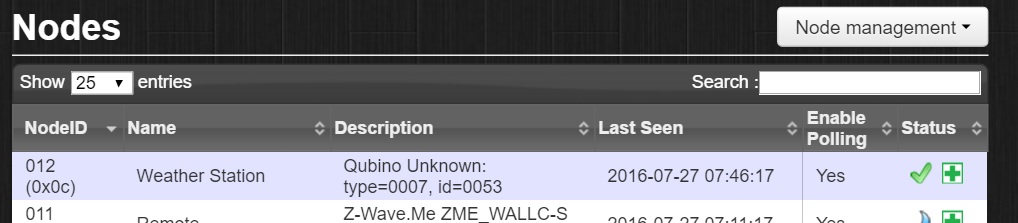

In config the ZMNHZDx.xml exists, manufacturer_sprcific.xml includes:
<Product type="0007" id="0053" name="ZMNHZDx Weather Station" config="qubino/ZMNHZDx.xml"/>
In Nodes: <see attachment nodes>

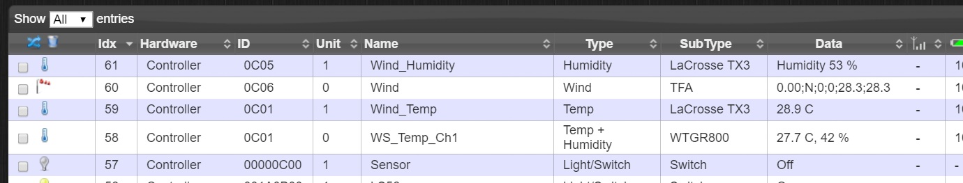

The devices that i have been abel to find during my struggle is:<see attachment devices>
OpenZWave: Version: 1.4-232-g4f7da52
Version: 3.5382
...have executed ./updatebeta .
- Dont receive direction from anemometer
- Dont receive data from thermo-hygro sensor on channel2
- Dont receive data from Rain sensor.

- Devices
- devies.jpg (93.58 KiB) Viewed 1528 times
- Nodes
- nodes.jpg (55.03 KiB) Viewed 1528 times
