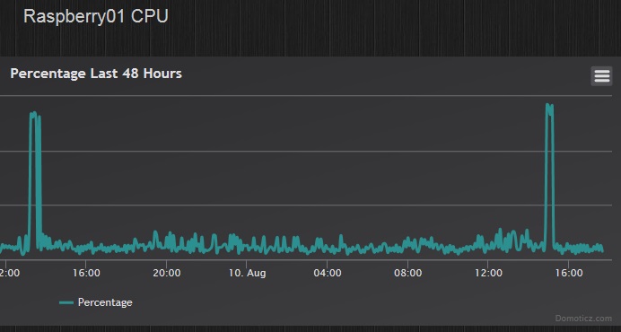

A very old thread I know but I'm still having high CPU problems and really have no idea where to look now so am after some advice. For the last year Monit has been restarting my Pi up to 3 times a day (average of once). Usual CPU load 3-4%, spikes to full CPU on occasions causing the reboot - if I disable Monit then the system locks up with high CPU anyway and I need to manually restart. Spikes seem to happen when a zwave event occurs (eg lights turn on either by switch or timer).
I've tried the following
* New Raspberry Pi (Domoticz restored from backup, everything else clean install)
* Replaced 3 x zwave modules (1 failed totally, 1 lost partial functionality, 1 I thought was faulty but seemingly wasn't)
* Hard reset of zwave stick
* Turned off all polling
* Added further zwave modules (13 in total) so that mesh network should be totally sound.
Does anyone else have problems like this or couls someone make suggestions where to look next?
