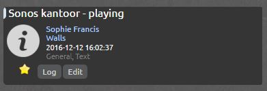

I have a virtual device of type text that displays the current track in Sonos, which works nice.
What I would like to do though is to set the icon to the current album art (I do have the url), is that possible?

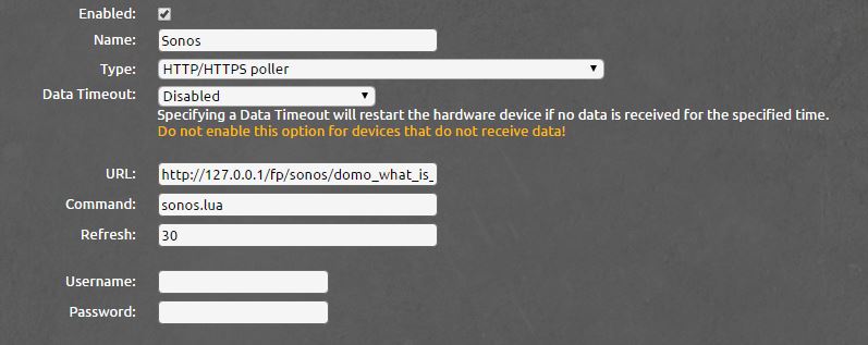

I am using the new HTTP poller in Domoticz to get song/artist from the Sonos and show it in a text sensor.
This checks the status every 30 seconds and works independent from the normal LUA scripts.
I call a PHP script in the poller, this uses the information from the Sonos Wrapper https://github.com/gerard33/sonos.
So you need that to get this working, but maybe you can use some of the code.

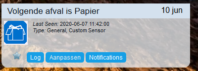

It would be nice to be able to modify all icons on all devices.
It would enable you to be much more informative.
As it is not possible I have been struggling to solve it another way and ended up using a custom sensor.
Not as much space as on a text device, but you can (mis)use all parts of the header.
Modifying that one took me some time, so I shared my snippet on github
https://github.com/robhiddinga/domoticz-tile-mod
