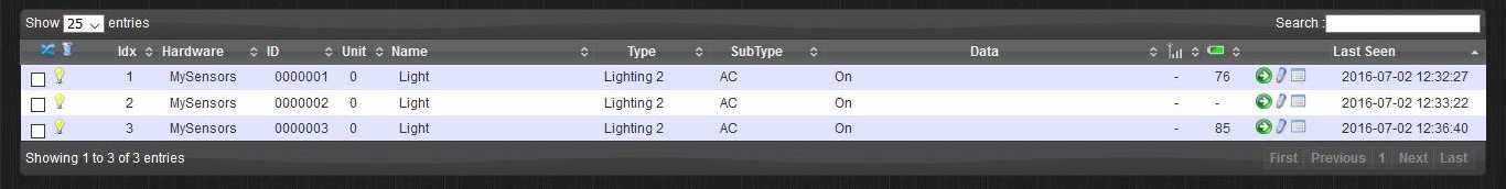

Are we talking about the same thing here... :-)
This is the battery level that I am referring to:
It seems that the battery level are just another value to the already existing sensor. I do not want to log anything, just have the possibility to update the value using sendBatteryLevel(). And to check once in a while that the battery level are still good.
But mabye that is not as easy from a code perspective? It just sounds strange that it would need a lot of extra sensors.
Best regards - and thanks for this wonderfull software!
