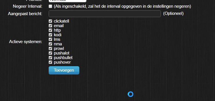

Derik
- Posts: 1605
- Domoticz version: BETA
Re: WhatsApp or Telegram?
i mis both options here,,,:
Can i send to different persons with Telegram?
Just use the HTTP option which you define in "Custom HTTP/Action:" for sending messages via the Telegram bot.
To send it to multiple devices you can use a chat_id of a GroupChat containing all person you want to send the text to.
