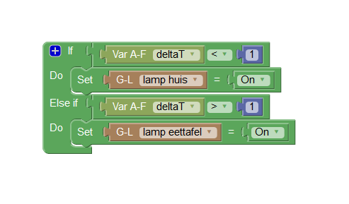

but now i did a simple test:
and !!tada!! nothing happens.... :cry:
lua script runs on time so updates my deltaT variable every minute.
but when i correct the user variable with the same value by hand then it works......
how is that possible????

Post by jvdz »
Funny, you are the second one asking this today. See my answer here: http://www.domoticz.com/forum/viewtopic ... 490#p89503

ok that makes it a little bit complicated for me.so if understand correctly i have to update my user variable via json with a variable number....delta t
can you help me with that line please jos?
i realy want to use blockly from here on with my delta value :)
i know a little about json but what do i have to fill in here : vvalue=.?.?.?.
jvdz
Posts: 2490
Domoticz version: 4.107
Re: delta t lua
Post by jvdz »
Can't test but something like this should be close:
commandArray['OpenURL']='127.0.0.1/json.htm?type=command&param=updateuservariable&vname=deltaT&vtype=0&vvalue='..tostring(delta)
