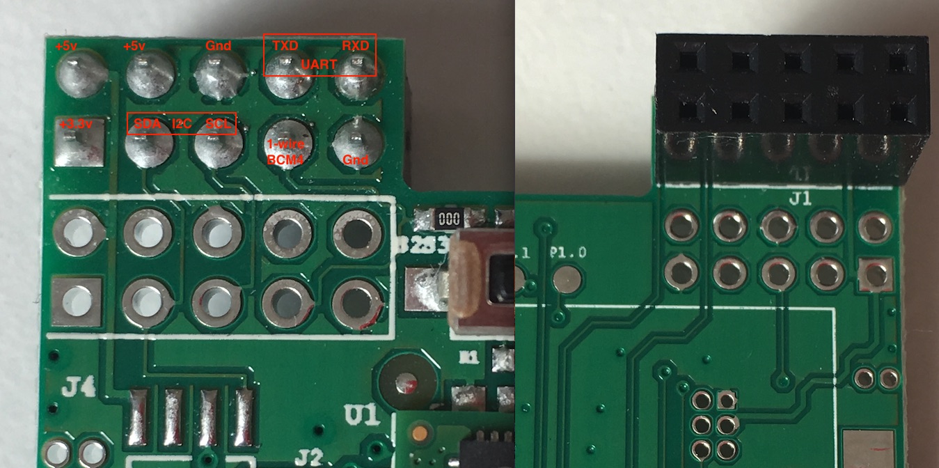

Re: Razberry + Raspberry GPIO port
As far as I know, the Razberry board uses Vcc, GND and the UART pins, the rest are there just to support the board.
I haven't tried but see the picture below, the pins within the heater are I2C, 1-wire and UART. The I2C seem to be ready for something not used like a future eeprom. BCM4 is connected to something but not sure what really is doing.
This is the Razberry 2 by the way.
- Razberry2 header.jpg (228.88 KiB) Viewed 3419 times
