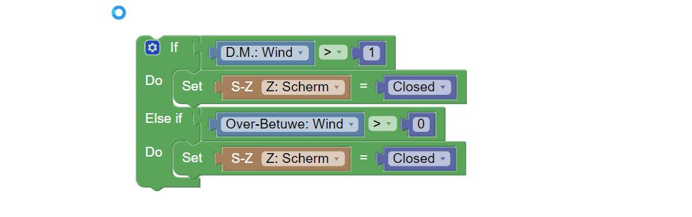

Dear All,
Is there a possibility that I can use my Blockley weather sensors .
Wind harder than 1 sunshade closed.
Only this is not working ..?

Dear Jan,
Please a screendump of your blockley...

Not sure if this helps, but have you tried using "On" or "Off", instead of "Closed"? I use a blind type switch for my Velux Windows, and they work well like that.

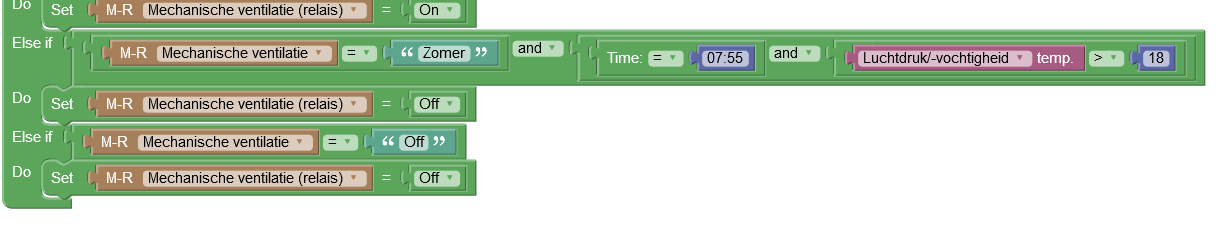

Hi Derik,
I hope it helps!

StanHD wrote:Not sure if this helps, but have you tried using "On" or "Off", instead of "Closed"? I use a blind type switch for my Velux Windows, and they work well like that.
Dear Stan,
That is the solution...
Strange way in blockley...
Only now working....
