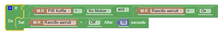

I have a Domoticz switch which turns on/off a relay (connected by using ESP Easy). This works fine.
I added a PIR sensor to this ESP8266, which also works fine.
Now I want to set the relay off, when there is no motion detected for x seconds using events. However this event doesn't work (other events work fine).
Could you please give me some support on the event below.
Thanks in advance! :)

Are you sure the state is 'no motion' of the pir?
Use the 'current state' function in the events screen to double check.

Egregius wrote:Are you sure the state is 'no motion' of the pir?
Unfortunately yes. See screenshot.

You mean no?
It says 'off' and not 'no motion'.
So change your script to if PIR Koffie == Off and ...

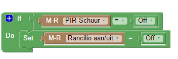

I changed and is not working. Seems that it is not possible to on/off the relay (Rancillio aan/uit) by using events. :S
Even the below event does not work (event is set on active, also under settings).

Did "PIR Schuur" actually change the status from On to Off when you tested as this blockly only will be triggered when the device changes status?
Jos
