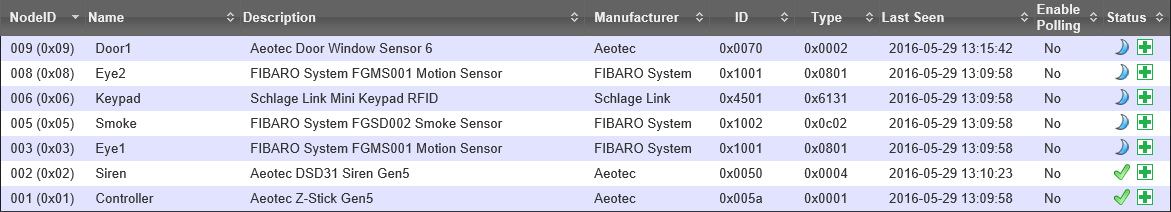

Node list
Node list

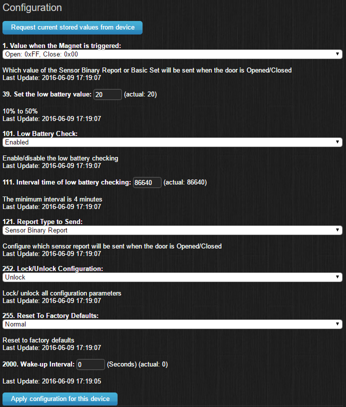

It works correct.
Standard this node sends a basic-report, you need to change this to a binary report as mentioned above.
Go to the openzwave hardware setup, select the door sensor from the node table
Now change parameter 121 to 'Sensor Binary Report'
Scroll down to the button 'Apply configuration for this device', but do NOT press it yet
Wake-up your sensor by pressing on the button, the light will be green, then press the apply button
urbaxe
Posts: 17
Joined: Tuesday 24 May 2016 0:25
Domoticz version: 4.10311
Location: Sweden
Re: AEOTEC Door / Window Sensor 6 (model ZW112)
Post by urbaxe »
gizmocuz wrote:It works correct.
Yes, I can now confirm that it works with Sensor parameter 121 set to 'Sensor Binary Report'.
My device "Door Sensor" will now go Off/On when the magnets are away and near the switch.
Thanks gizmocuz, in your interest for helping me.
Configuration_AEOTEC Door_Window_Sensor_6_(model ZW112).png (185.61 KiB) Viewed 6519 times

After installing and having them work stable, I went to settings --> Hardware --> Open Z-wave --> Settings.
Select the ZW112 sensor.
Change Param 01. Low Battery Check: to "Enabled";
Change Param 121. Report Type to Send: to "Basic Set and Sensor Binary Report".
Click the Apply button.
Go to the physical sensor and press the action button for three seconds. The led should be "purple".
To be sure, I clicked the Apply button again.
Repeat this for all sensors ;-).
Now in devices the battery-level is displayed as 100% (I charged them two days ago).
I am interested to see how this develops...
